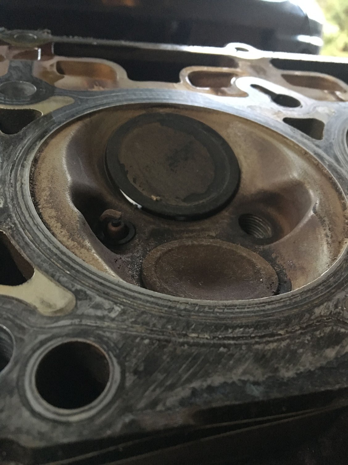

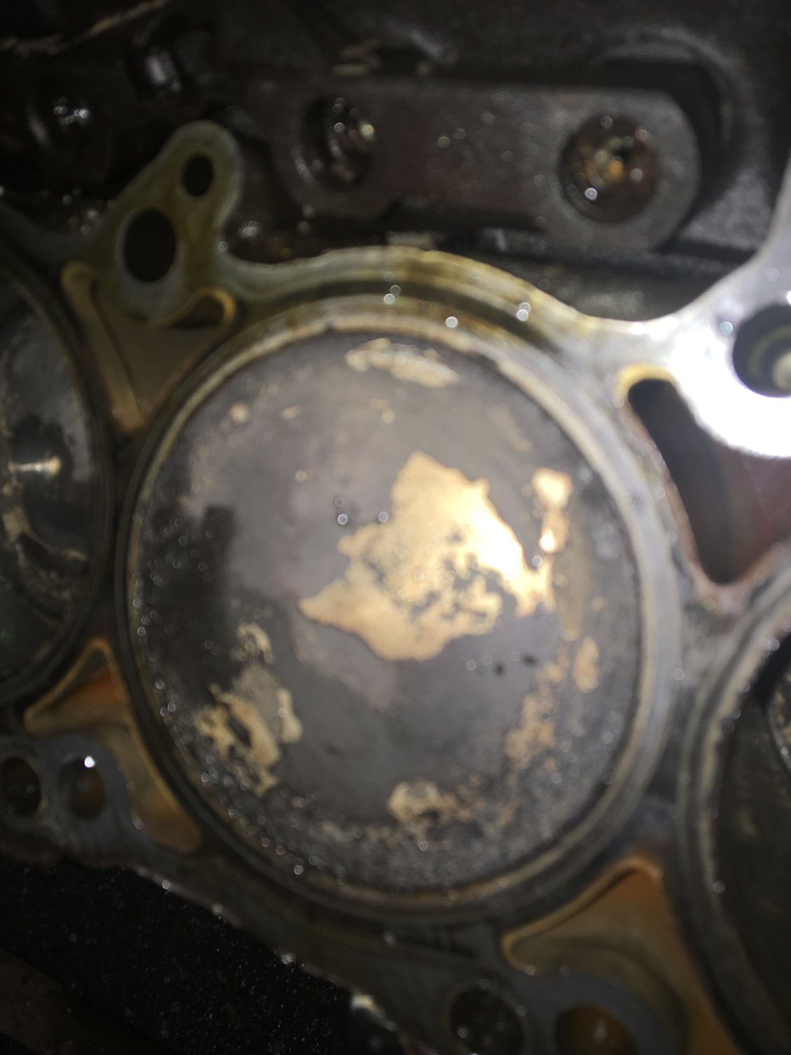

Old Jul 24, 2018 | 11:26 PM
  #45
Dukeshow's Avatar
Dukeshow
Joined: Jul 2018
Posts: 39
From: Castlegar

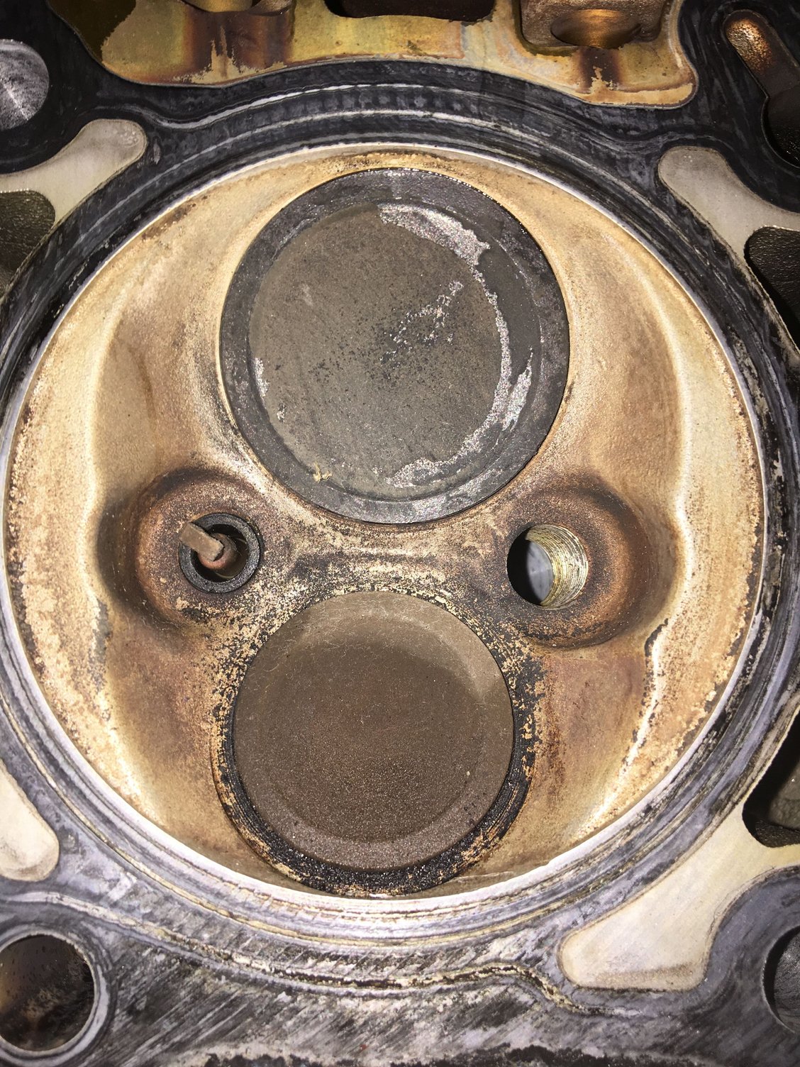

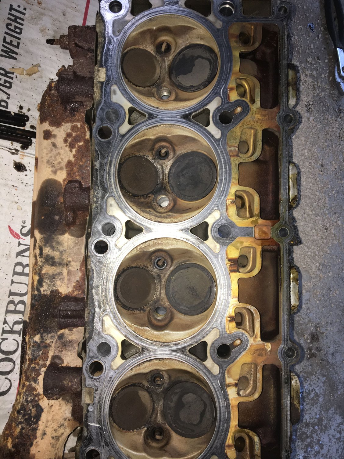

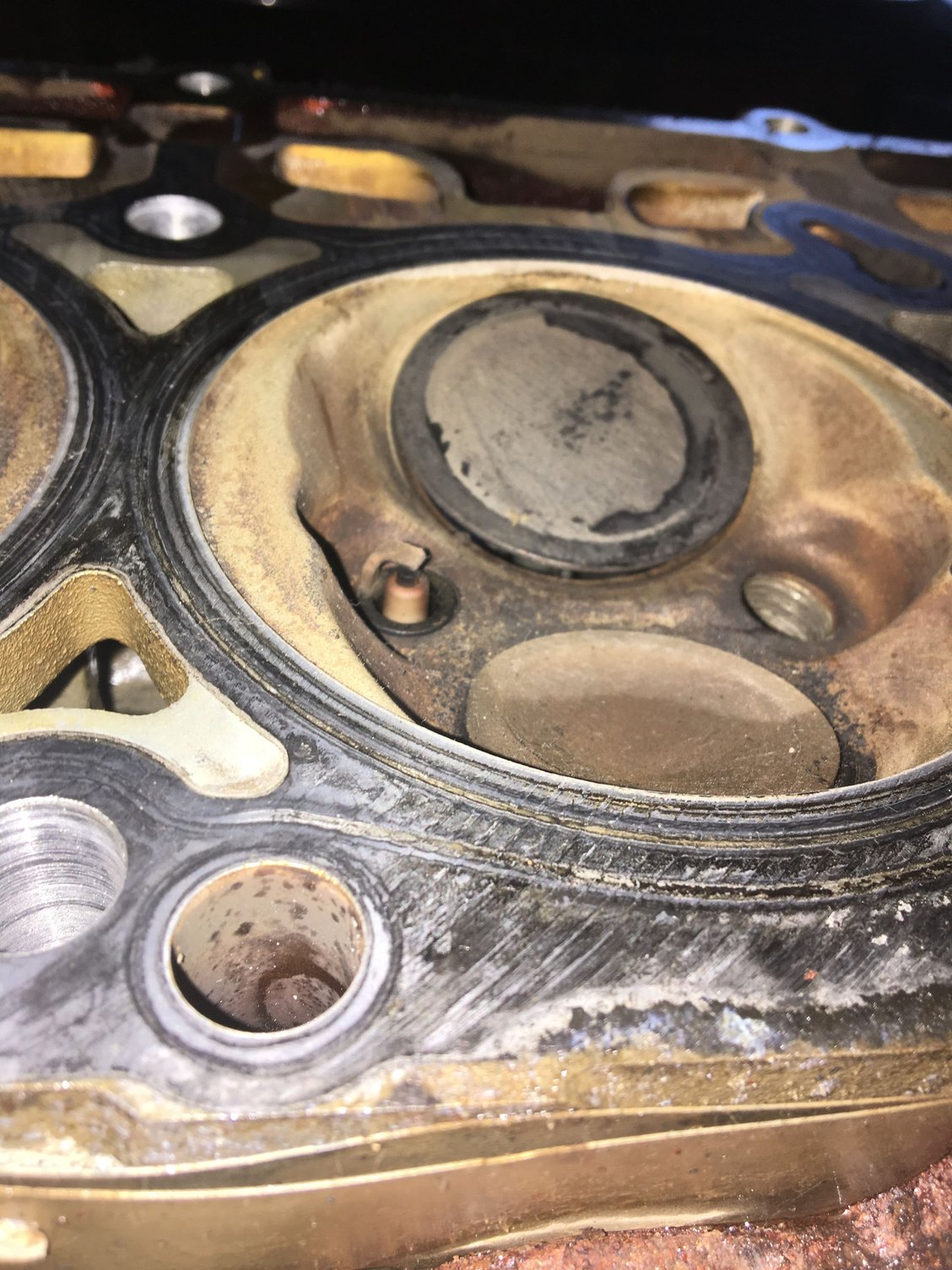

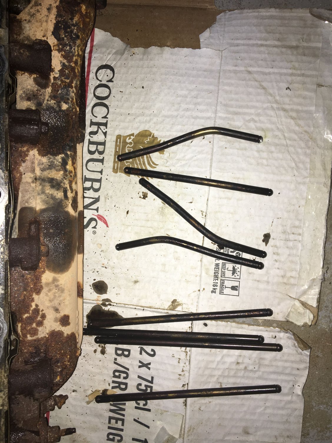

Old Jul 24, 2018 | 11:27 PM
  #46
Dukeshow's Avatar
Dukeshow
Joined: Jul 2018
Posts: 39
From: Castlegar
Intake valves are all bent
Old Jul 25, 2018 | 08:12 AM
  #47
Posts: 87,465
Likes: 4,220
Wow. What the heck happened????? Did your timing chain fail?
