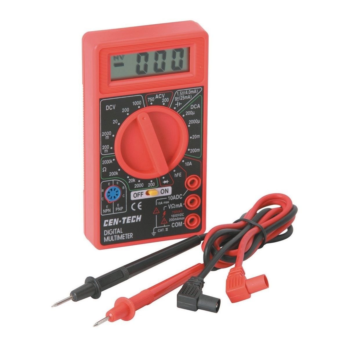

You need to figure out which connector you need to pull from the cluster and independently test continuity on the wires. I would just see if that black wire is grounded. If not, ground it local to the buckle and get on with life. If its the other wire, you'll need to pull the connector and see if its electrically broken. If it is, run a new wire. If its not, and the black is grounded, and the buckle shows that when you click in the belt that it mates black and green.... Then you likely have an instrument issue.
Go watch some multimeter videos, buy a cheap one from harbor freight, and get busy. Or just go get your local shop to do it for you....
