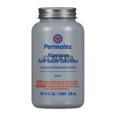

Congrats, rust is a b*tch. If you haven't already been incentivized to invest, I bet you're ready to now add anti-seize to every fastener you're going to install..
Old May 21, 2019 | 07:25 AM
Posts: 87,429
Likes: 4,215
I love that stuff. Won't turn a wrench without it.
