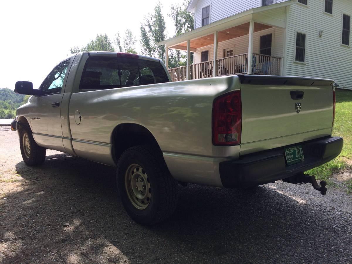

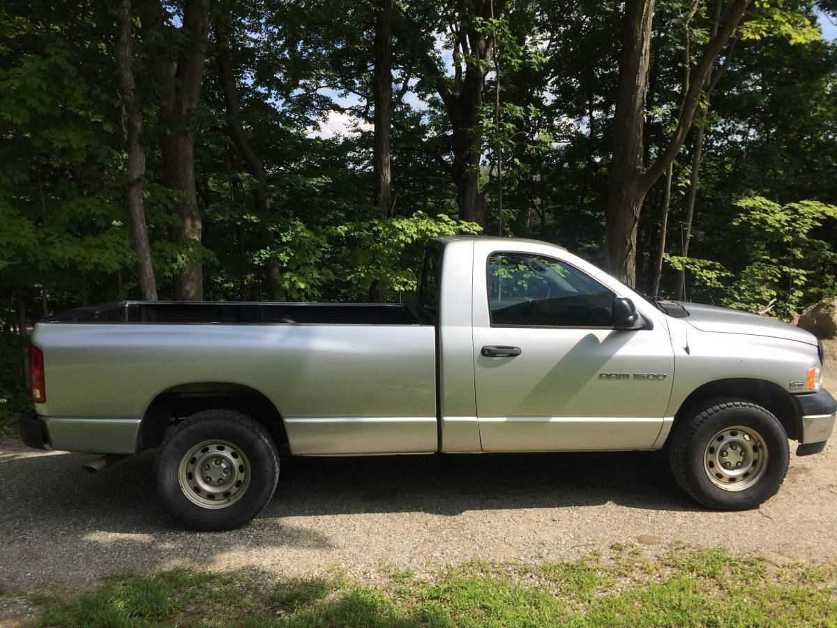

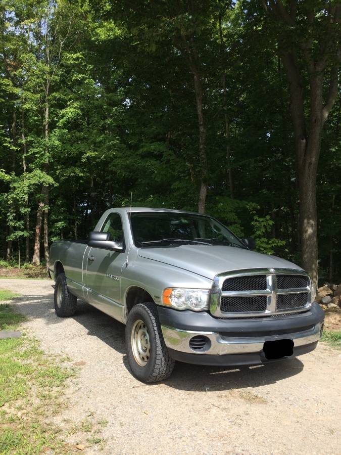

Here are the pictures ... hard to see but there is a good dent in the front bumper.

Pics don't show any concerns. My nephew had a 3rd gen 1/2 ton in VA that when they put it on a lift the frame sagged due to rust damage. Check the the frame, make sure its solid.
