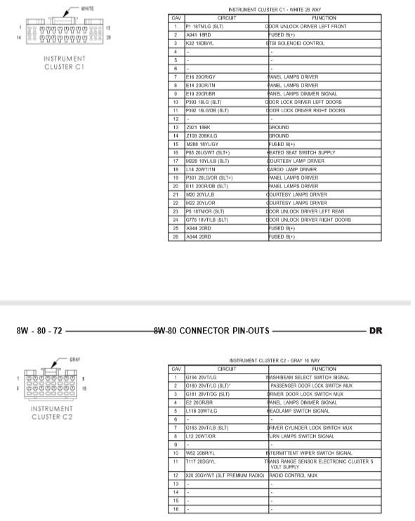

trying to change out instrument cluster bulbs. anyone out there have a pin out location? i need to get power to the cluster to bench test the lights

didnt really help. i need to bench test for the new bulbs. trying to find which pin powers the lights and ground

Why didn't it help? There is a whole description section on Instrument Cluster, including about half a page on lighting. And all the pin-outs are available in the pin out section. What else do you need? Pics below are incomplete and only for reference to prove the info is in the manual, see actual manual for complete information.
