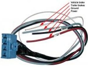

There generally is a nice connector under the dash to plug in an aftermarket brake controller, keeps you from having to cut up your factory harness. Most brake controller manufacturers have the harness plug.
https://www.tekonsha.com/products/br...wivxzJho5S5JFc

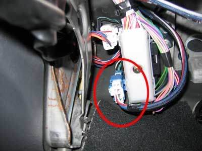

3rd gens NEVER came with factory brake controllers. There is a spot to connect one, but you have to get your own. You need the blue plug to go here:
Old Sep 16, 2019 | 01:45 AM
primem's Avatar
primem
Joined: Apr 2013
Posts: 1,815
Likes: 56
From: Alberta
and don't just plug and play...check the outputs. I bought a factory connector and the wires were inserted wrong...if I hadn't checked...I would have destroyed my brake controller.
