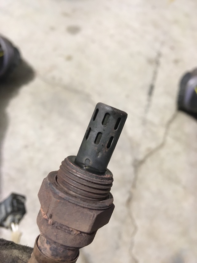

This evening I did three things.
  1. Pulled up the fuel rails and pressurized. Turned key to run and listened for fuel pump. Left it like that for 10 minutes then went looking for evidence of drips from each fuel injector. None found.
  2. Swapped positions of B1S2 (suspect) with B2S2.
  3. Went for a drive and captured some data.
Results:
- No fuel injectors are leaking, none stuck open
- Truck logged a pending code P0157. B2S2 low voltage. The problem followed the sensor. Can conclude definitively the sensor is shot.
- The initial logs of O2 sensor voltage shows definitively the anomaly followed the sensor to the new location B2S2.

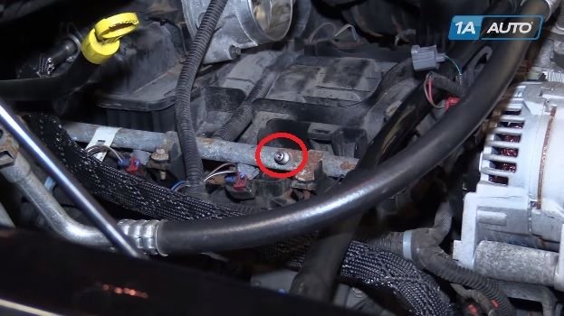

Ok, details... How did you conclude that w/o the use of a pressure gauge on the rail? BTW, looks like Dodge provides a schrader valve on the right side rail on the 5.7 hemi.
Buy NTK (OE).

Default schrader valve location for fuel pressure test
