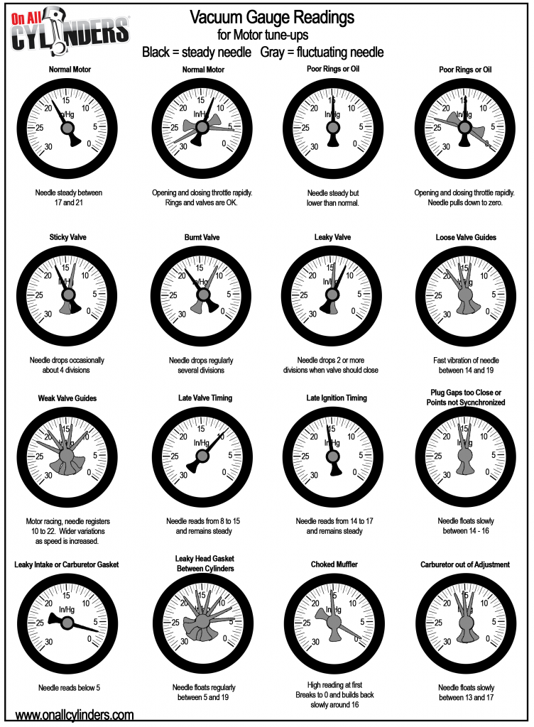

If you had a $20 independent vacuum gauge, you could validate on your own. But a quick web search yields you are still pretty far out of spec:
: https://www.motor.com/magazine-summa...-vacuum-gauge/
Inches of Altitude Vacuum:
Sea level-1000 ft. 18-22
1000-2000 ft. 17-212000-3000 ft. 16-20
3000-4000 ft. 15-19
4000-5000 ft. 14-18
5000-6000 ft. 13-17
I haven't bought a new MAP for a Ram.... I'm usually working on vehicles that are 10 years old and under, MAP is a rubber diaphram, and rubber lasts a while - but not forever. Typically I'm replacing EGRs, o2 sensors,,and maybe a temp sensor. Once I had to buy a good used PCM for my 04 1500. Now that the kids are driving, I've bought a couple much older used cars and to combat insurance costs - I'm buying used and 10+ years old with 100k miles or more.
A map sensor isn't very special, but anyone can generate poor quality. I'd go with a name brand, or the OE supplier for Dodge.
I'm still recommending the independent vac gauge!!!. You could confirm your suspicions and check out the replacement.... Plus its an easy and fast way to check out an engine. Plug it in and look at the dial face. I'd print the Gauge reading ouija board out and put it on a poster in your garage
Looking at Vac can tell you a bunch about engine condition.
Other things could be causing a low vac signal.... have a look a that vac ouija.... I'd hope its just a bad MAP sensor. My 04 2500 5.7 has 165k miles on it and torquePro reports it as 21 in/HG at idle. We are about 1300 feet above sea level.
