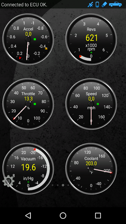

I see the disconnect. TorquePro has a vac gauge (among others) on its basic screen. I just use that initial screen to see the vac at idle then watch it when I blip the throttle. Then I end up scrolling off to the right to add the fuel trims and timing advance. I'd only pull more pids if I saw something looking wrong. I've assumed that Vac gauge is using the MAP sensor, so I basically equate the two - and I've got the vac ouija chart that I shared in my mind when I'm looking at vac. That is why I was so confused when you were calculating vac!

My scan tool, BlueDriver, gives the MAP reading. It looks like perhaps the TorquePro is doing the math in the background for you in order to display a vacuum value? Can the TorquePro display the actual MAP PID? It would be a good direct comparison if you are able to see MAP, the VAC, and ambient barometer side by side on the TorquPro screen.
