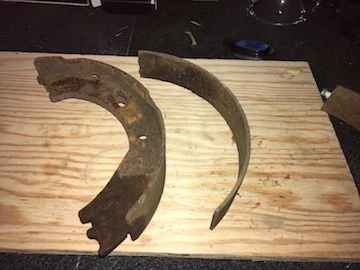

What I would like to know from the brake experts is what glue / adhesive to use to reattach the brake lining material to the park brake shoes. Was servicing my park brakes on the weekend. The linings are like new wrt thickness, but have completely separated off of the shoes. A layer of rust managed to etch its way perfectly between the shoe and the lining like a precision knife cut. 3 of the 4 shoes have cleanly separated like this. I'd like to glue them back on and finish up the brake job. Sure, I could buy new shoes. But why go blow 120$ on parts when these are barely used and seems like could be easy enough to repair. I could probably scuff them up and use some hi-temp epoxy?

you can't/shouldn't. buy new. I have seen them detach...when the driver goes to back up...the wheel locks.
I had a tractor that I couldn't buy new shoes for.... I found a local place that relinged shoes - but it would have been cheaper to buy parts store replacements than a custom job. I'm sure they have barely EPA legal adhesives and probably sandblast then coat the metal with anti-corrosion. Recommend you just buy new ones.
It takes adhesive and pressure. You can do it your self but you'll have to buy a press and an oven to bake it. New shoes are cheaper.

Found what I need! This is what I am going to use. Says its good for it right on the tube so it is perfect. Going for it.
