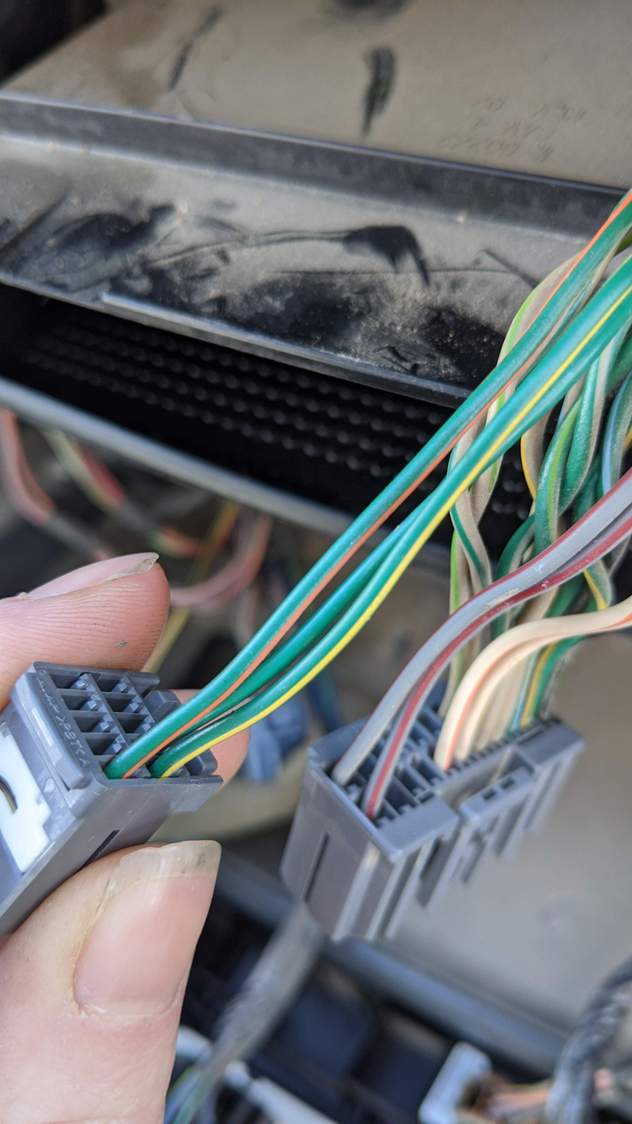

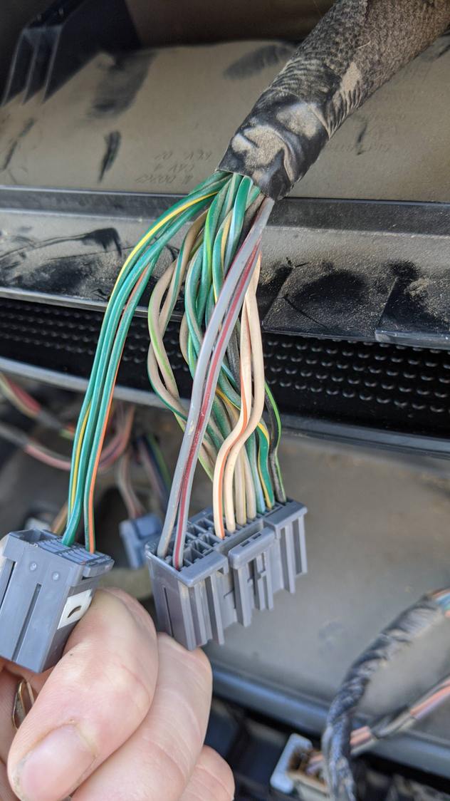

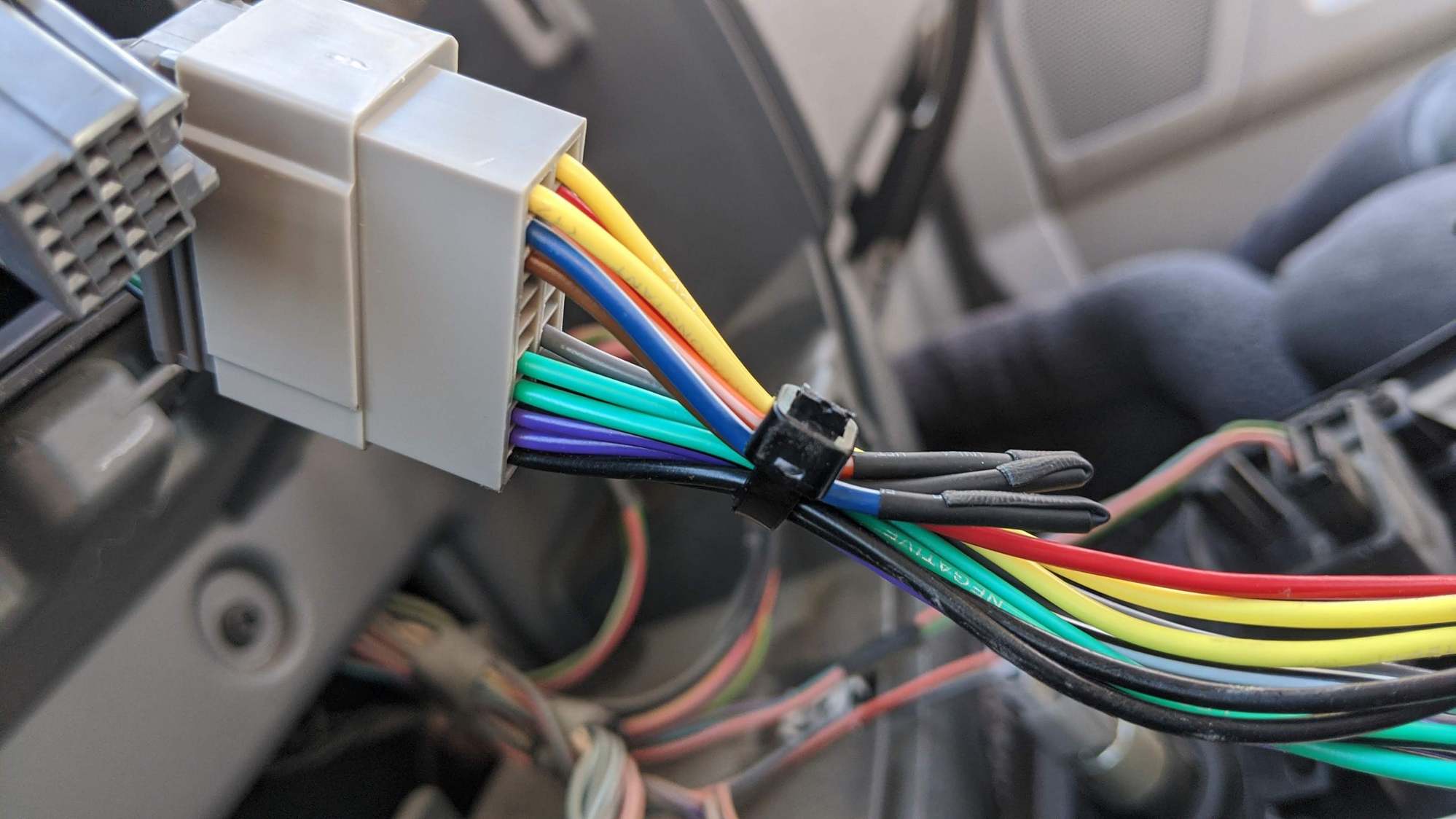

Hey all, just got a 2008 Ram 2500 and I'm trying to replace the stereo... It took me a couple tries to find a harness that worked and the one I have now still doesn't encompass all the wires that went to the stock stereo. I'm wondering what I'm doing wrong? The wiring diagram found on http://www.modifiedlife.com/2008-dod...comment-816772 looks completely different than what I have.

It looks like you have the basic wires connected and I suspect you are getting sound from your radio. Wiring harnesses are standard and many trucks have wiring plugs that are not used. The blue/white wire for instance, would connect to a factory amp. Other wires may connect to reverse sensing for a back up camera, or to a Nav system.
Are you getting sound from the radio? Does the interior light dimmer function work? Does your door chime still work? Let me know if there is a problem and we can work from there.

I'm getting no power to the stereo at all, so no sound. I know my solders are good and the stock stereo that was in before worked so that pretty much knocks out the internal wiring as the problem. The light dimmer and door chime both work fine.

A couple of questions:
- what color wires from the truck are not connected?
- what radio system do you have? 4 speaker, 7 speaker with infinity amp?
- what wiring harness adapter did you use (number, manufacturer)? Does wiring adapter have a module on it to set brand of radio?
- did you check the fuse on the back of the unit? You can check the fuse for continuity with a multimeter without removing the fuse.
I'm thinking there is a bad connection for power or ground.
