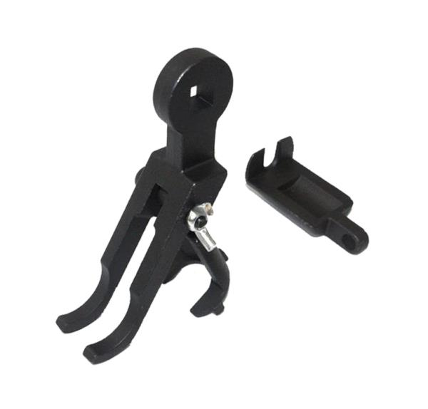

Only special tool I am aware of being needed, is something to pressurize the cylinders, to hold the valves up while you have the springs and such off. Some folks just stuff cotton rope into the spark plug hole, then turn the motor so the piston holds the rope against the valves, thus preventing them from dropping into the cylinder.

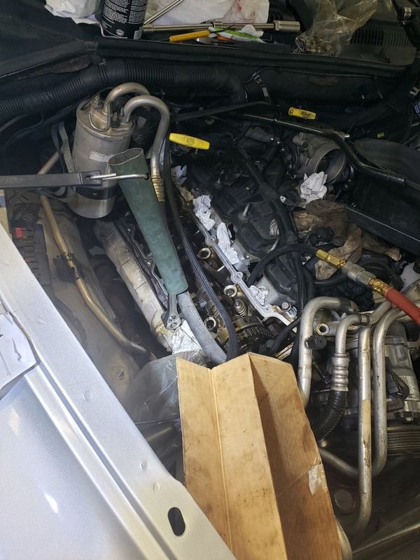

I will say, however... it does make the job much more difficult/tedious when doing the seals. Compressing the spring to remove lifters is one thing. With the engine rotated so the cam is at a low point, it's pretty easy get them out. Heck, you can lever them in and out with no spring tool, if you watch some youtube vids. Compressing the spring enough to remove the keepers however, is more difficult. It requires a great degree of spring compression and you'll probably have to remove the fuel rail in order to get enough room for your wrench to travel. Once you have the keepers off, the spring comes off and then you're at the valve stem. Do the sealss if you plan on keeping the truck a long time. It's double the work if you have to go back in again.
It is very tedious, and can be downright difficult when compressing the springs that are up against the firewall. I've got a Dakota, so it may be easier on a Ram, assuming a larger engine bay. I had to loosen the brake booster and let it hang out of the way sorta, just to get the driver's side valve cover off. I had a really hard time with the passenger side valve keepers furthest back. That is the most difficult part.... getting the keepers back in by dabbing grease on your finger and having the keeper stick to it as you maneuver them into position. They tend to fall off and get lost. Also things under spring tension can slip and go flying, never to be found. Having a few extra keepers and spring retainer caps before starting is a good idea. There are 16 stem seals in all... two per cylinder (intake & exhaust) and the same amount of springs to compress. There are 32 valve keepers in total to remove and reinstall.
The combo tool I mentioned has two legs, one for each purpose (removing springs/keepers vs lifters). You'll need an air compressor and a valve keeper hose for screwing into the spark plug hole.. (or rope If you want to go that route)... You'll the requisite sockets and wrenches + an extending magnet to snag the keepers. You'll need a fuel rail disconnect collar (cheap plastic ones are fine). You'll probably need a helper... or review my thread for the contraptions I got it done with, while working alone (covid...I had no choice). I wrapped a rag around a screwdriver sprayed with brake cleaner and cleaned each lifter hole as I went along. You also need to stuff rags into all the holes so things don't fall into the engine, down spark plug holes, injector holes, etc. Lots of stuffing on a big turkey. LOL

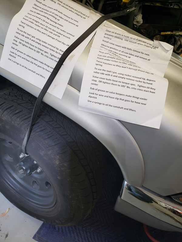

Very important: You must rotate the engine so the piston you're working with is at TDC. I stuck a screwdriver in the spark plug holes and watched it rise to max height as I rotated the engine. The valves hit the cylinder at TDC, so no worry of them falling in if air compression is lost. Forget to do this and you could be in for a world of hurt. Driver's side cylinders sit at a steeper angle than passenger, so when using this method, you'll have to keep pulling the screwdriver out if the piston locks against it.
See my valve cover install thread for the rubber band trick. https://dodgeforum.com/forum/2nd-gen...ue-or-rtv.html
Sorry if my writing is a bit disjointed...just trying to relay from memory. If you end up needing part numbers, etc., LMK.

Is that the tool that people in some youtube videos substitute with a bent 10mm open end wrench?Originally Posted by Dodgevity
I still have the combo tool I used to remove the rocker arms and valve springs.

The bent wrench only removes rockers. You can't remove springs and seals with a wrench and you certainly can't install them with one. The combo tool takes the place of two Miller tools.Originally Posted by 10break
I used rubber tarp straps attached to a pipe handle to hold the wrench in place while the spring was compressed. I hooked them wherever I could to get the job done...sometimes into the wheels. I also kept notes to remind me of things...ended up not needing them. It all flows as you do it. I did other things as I went along. New serpentine belt & spark plugs. Regreased all my "sealed" pulley bearings on idler and tensioner pulleys. Cleaned out the oil fill tube. That was a mess. AC compressor was pushed to the side with lines still attached. Fan and shroud were removed. Kept a tube of dielectric grease and a toothbrush... greased every single plug I pulled, as I went along. Also greased the coil boots and spark plugs. All that grease helps next time I disconnect things and keeps things water resistant when I wash the engine.

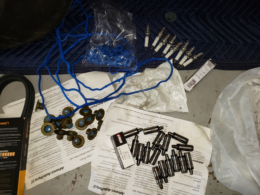

That's a badass project. I just replaced the rusting oil pan, gasket and pickup tube and was happy to see nothing gunked up in the old one. How many of your lifters were bad and it looks like that tool uses a 3/8" drive to compress the new springs? At 206,000 miles, I don't have any problems, that I know of, with my 4.7 but was thinking of doing this and timing chain as a preventative cuz its bound to happen some time.Originally Posted by Dodgevity

Yes, the tool is 3/8". Only one lifter failed completely, but they were all "bad." The springiness was gone from the plungers. I could actuate them by hand by lifting the plunger but it would fall back down as I let go. The bad lifter seized completely and spit out the rocker. I was lucky it didn't cause damage cause I already had all the parts ready to do the job, but kept procrastinating...till one finally failed. The rocker eject and quarantine time left me with no excuses.Originally Posted by 10break
So if you hear that diesel clatter on startup, change out the lifters. They may work for years, but eventually they will fail.

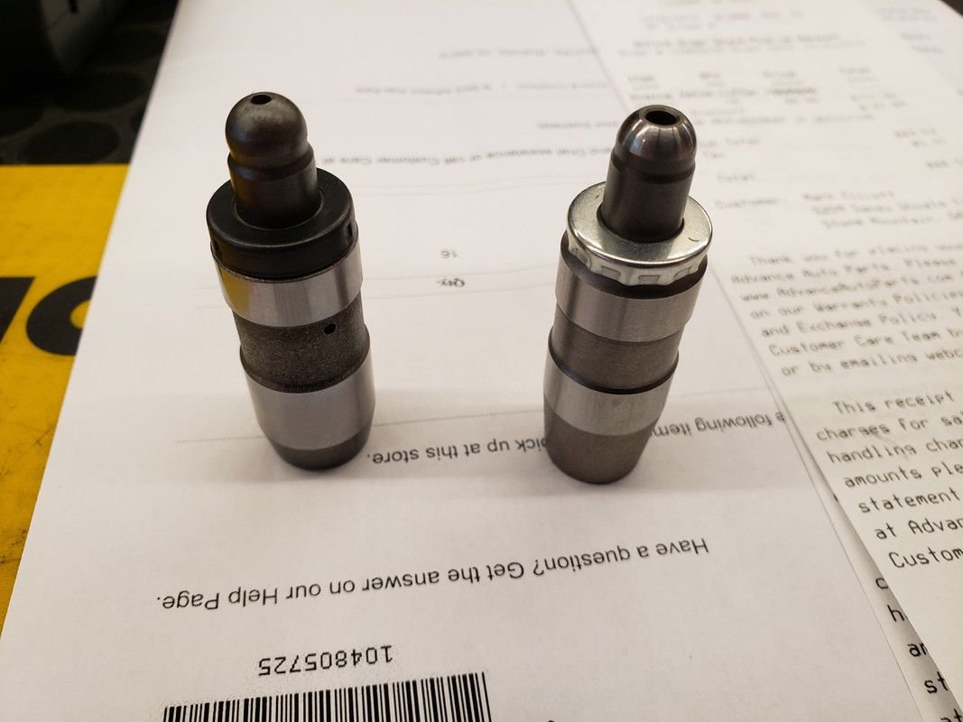

Here is a pic of the Sealed Power lifters. These are actually the same part number, but these were what I found when I opened the boxes. The one on the left is redesigned, supposedly to combat the bleed down, according to Federal Mogul (I called to inquire). I was able to get all but one of the redesigned lifters, so one of my lifters has the chrome cap you see on the right and all the rest are black caps.
