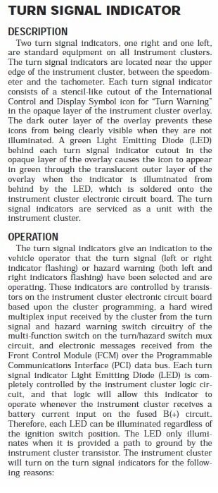

Old Oct 25, 2020 | 12:23 AM
Magnoom's Avatar
Magnoom
Veteran: Navy
Veteran: Coast Guard
Joined: Apr 2019
Posts: 1,680
Likes: 262
Here, since you wanna cry about it lol, straight out the FSM
