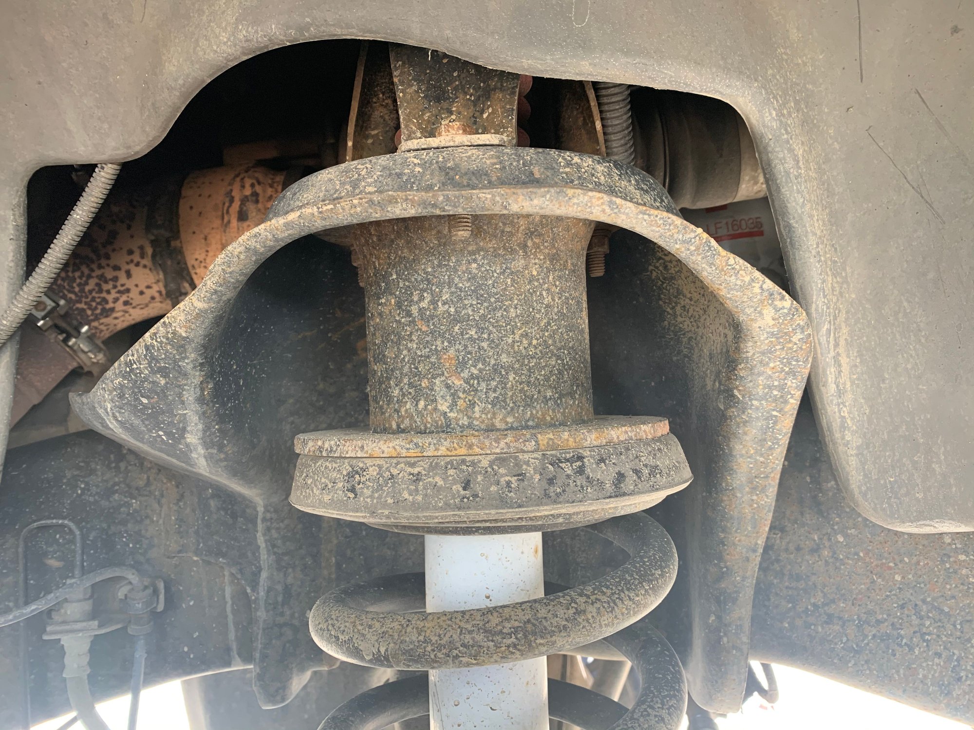

Look on top of the front springs. Are there spacers in there? Any tags or identifying marks on the springs?
This is my front spring.
Old Nov 8, 2020 | 03:04 PM
Posts: 87,400
Likes: 4,214
Those are some pretty serious spacers.....

So then most likely a lift kit. I just need to figure out what height now. I need to lower my truck to pull 5th wheels I’m being told.
Old Nov 8, 2020 | 04:17 PM
Posts: 87,400
Likes: 4,214
Measure that spacer, that'll give you a good idea of how much it was lifted.. Take a look at the back, and see what they did there as well.

Ok thanks. I’ll do that. Is there typically a spacer of some thickness there on a stock suspension?
Old Nov 8, 2020 | 06:43 PM
kejobe's Avatar
kejobe
Joined: Aug 2010
Posts: 2,241
Likes: 12
From: Ohio
Yes. But off hand not sure the thickness. The front definitely has a spacer lift/level.
