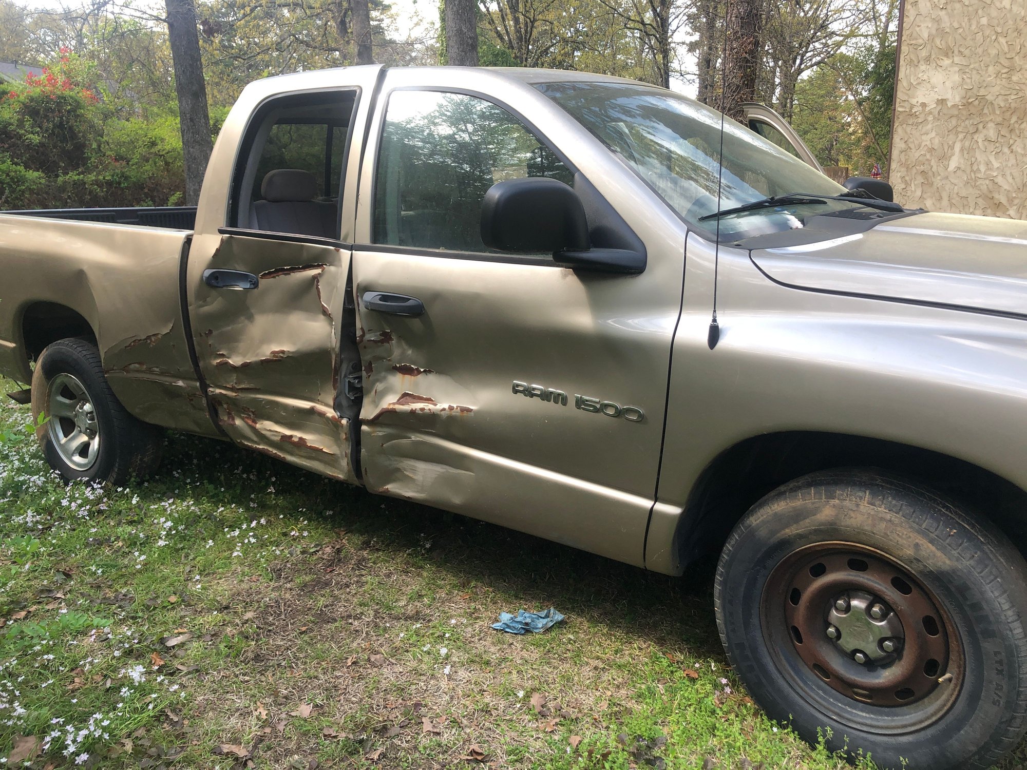

Ok so the truck originally got parked cause my dad wrecked it out, got hit right on the cab corner of passenger side. After it got hit he drove it 62 miles to our farm and parked it.

im attaching a picture of the truck just because I’m amazed that it survived.
to this day he won’t tell me what he hit, or what hit him.

Is the gas in the tank or fuel lines 10 years old? How about the lubricants and fluids?
Those trucks are being parted out all the time on craigslist. You can fix that.
My guess is animal impact. It's got that body outline look to it.

looks like my dad watched a little too much nascar lol!
