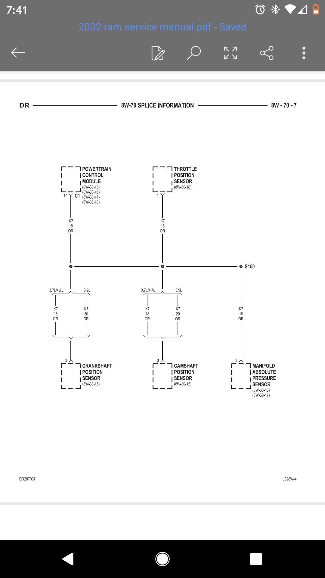

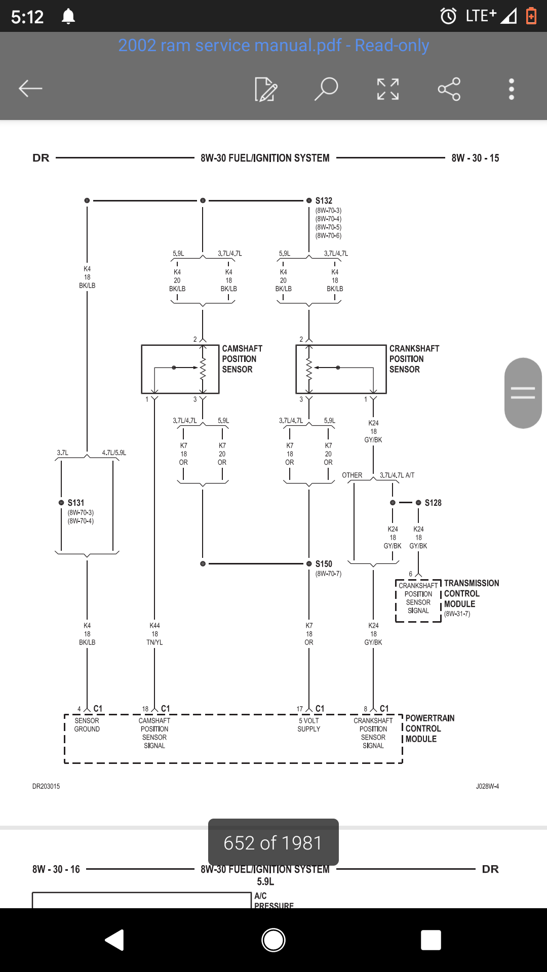

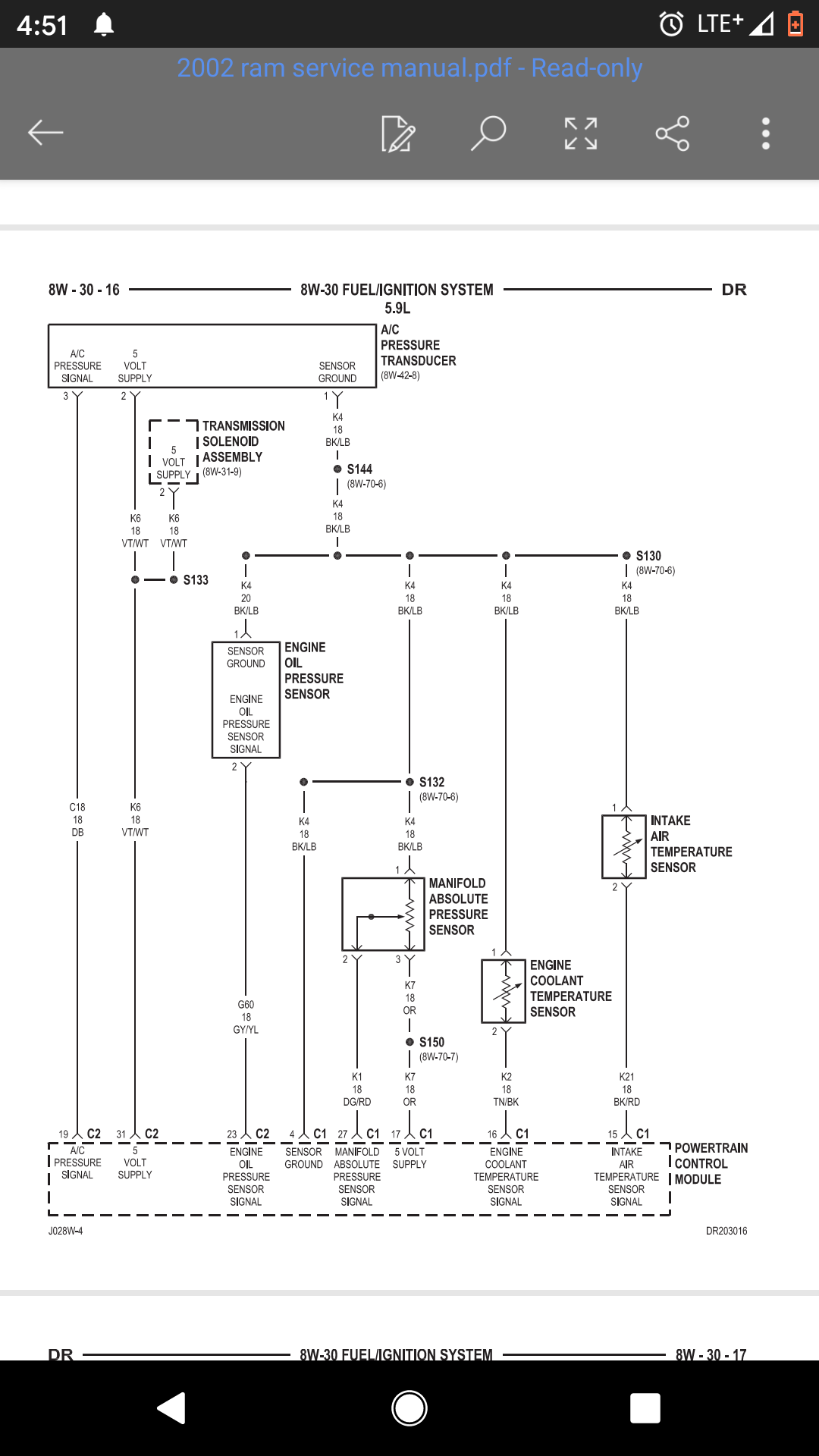

Hmm, how about that. I've got my hands on the factory manual for this year, model etc, and I don't see the connection between the map, TPS and range sensor in a5v circuit.
e connection between the map, TPS and range sensor on that 5v circuit... Where do you see this?

Sorry, that message and attachments may have come out a bit screwy, just getting used to this. I did run a wire from the map sensor for voltage to the pcm, but that wouldn't actually rule out a short in there, if it goes elsewhere...

There is a splice in there somewhere, I suspect it is S150 there, and I don't see the TPS in that diagram either......
Yup, here you go, you're right. I have to ask how the heck you know all this. Do you build these trucks? I've been wanting to talk to whoever designs these, I can tell you haha!

Thanks for this great message hey you. I'm away today, but will tackle more splices and connections tomorrow and keep you posted. Interesting to see the trans solenoid in the circuit with the range sensor, since it was throwing a code occasionally.
