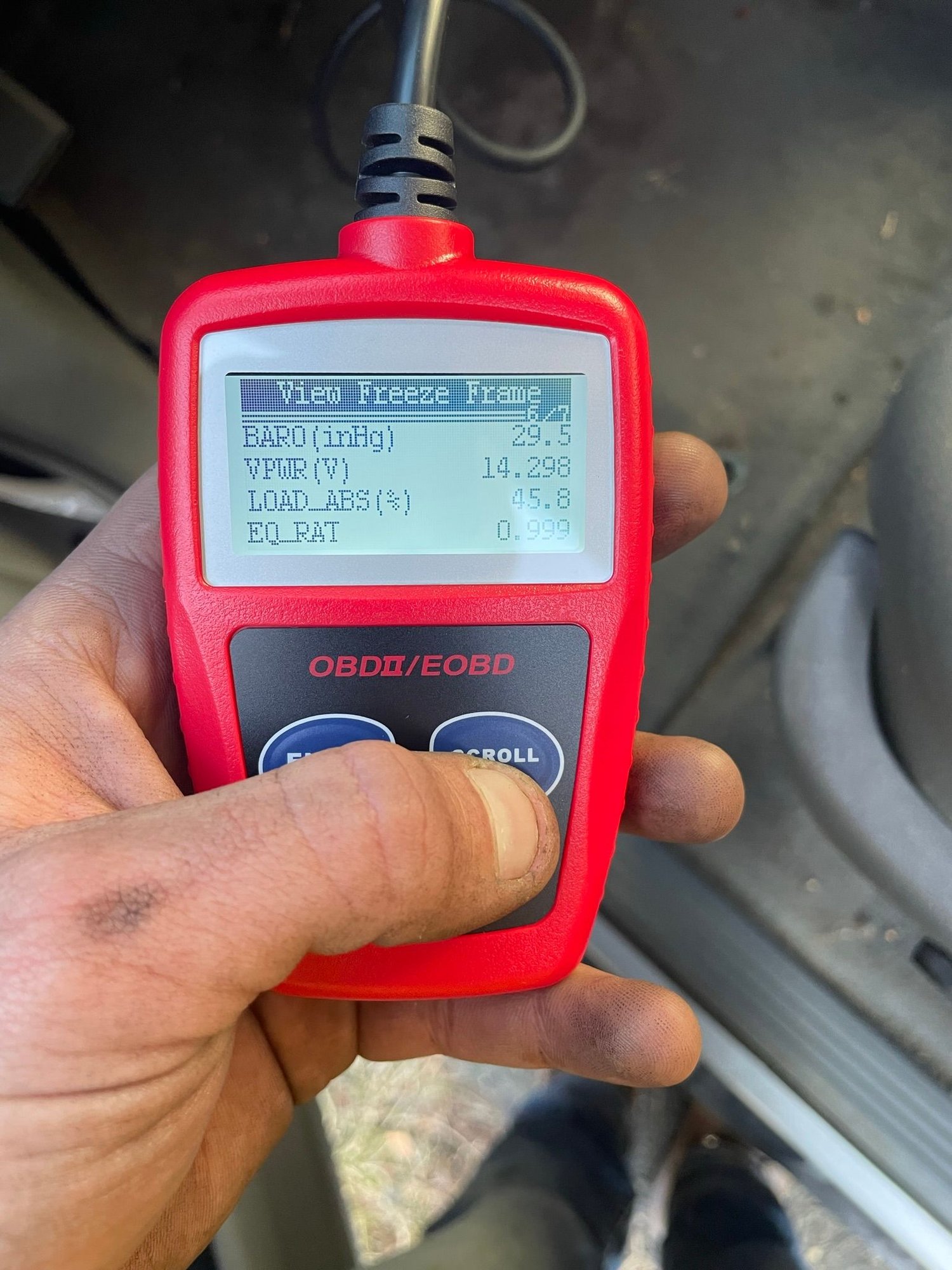

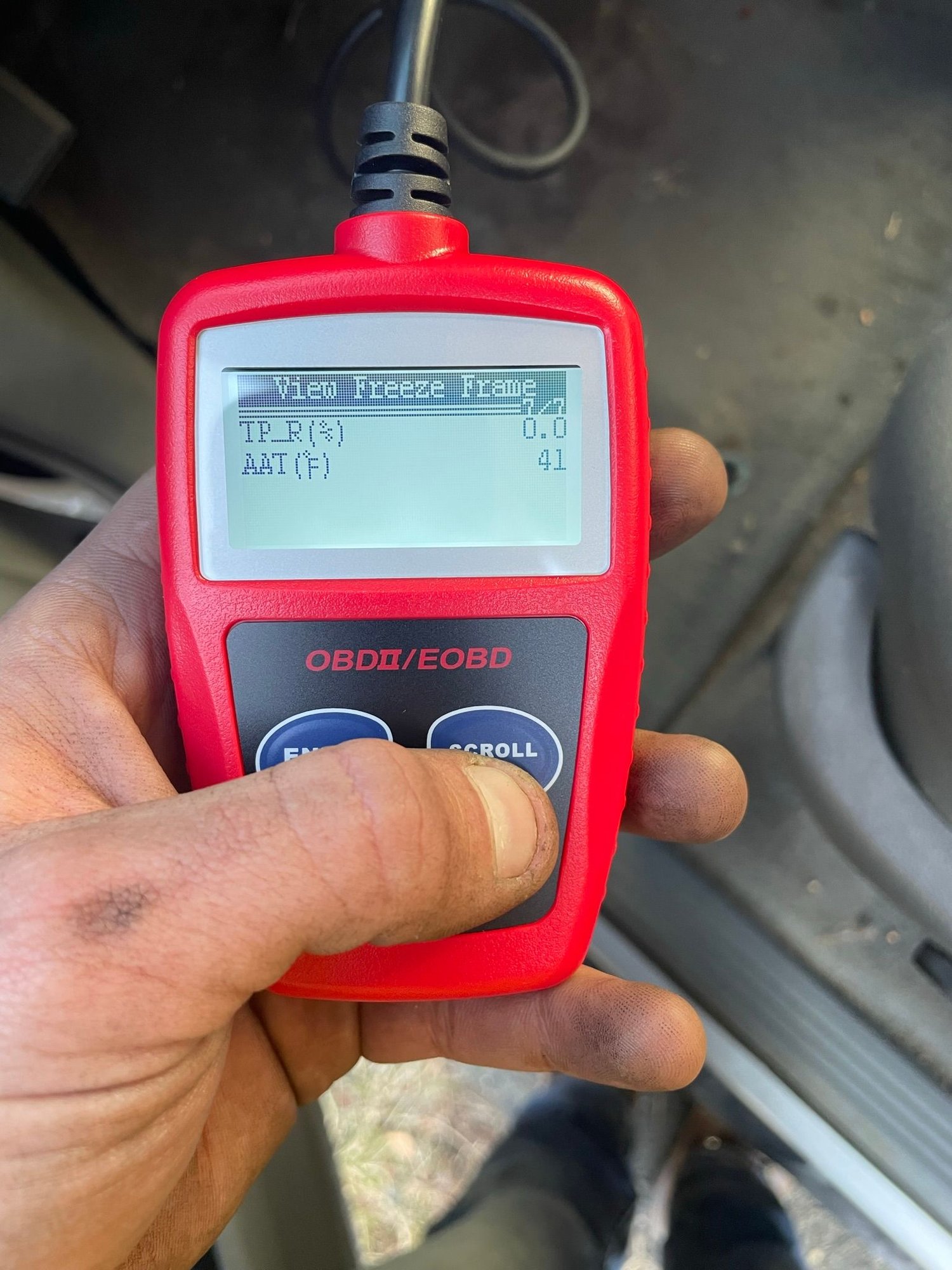

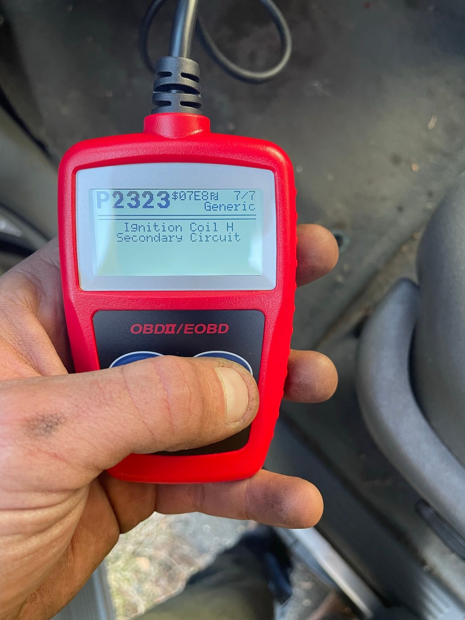

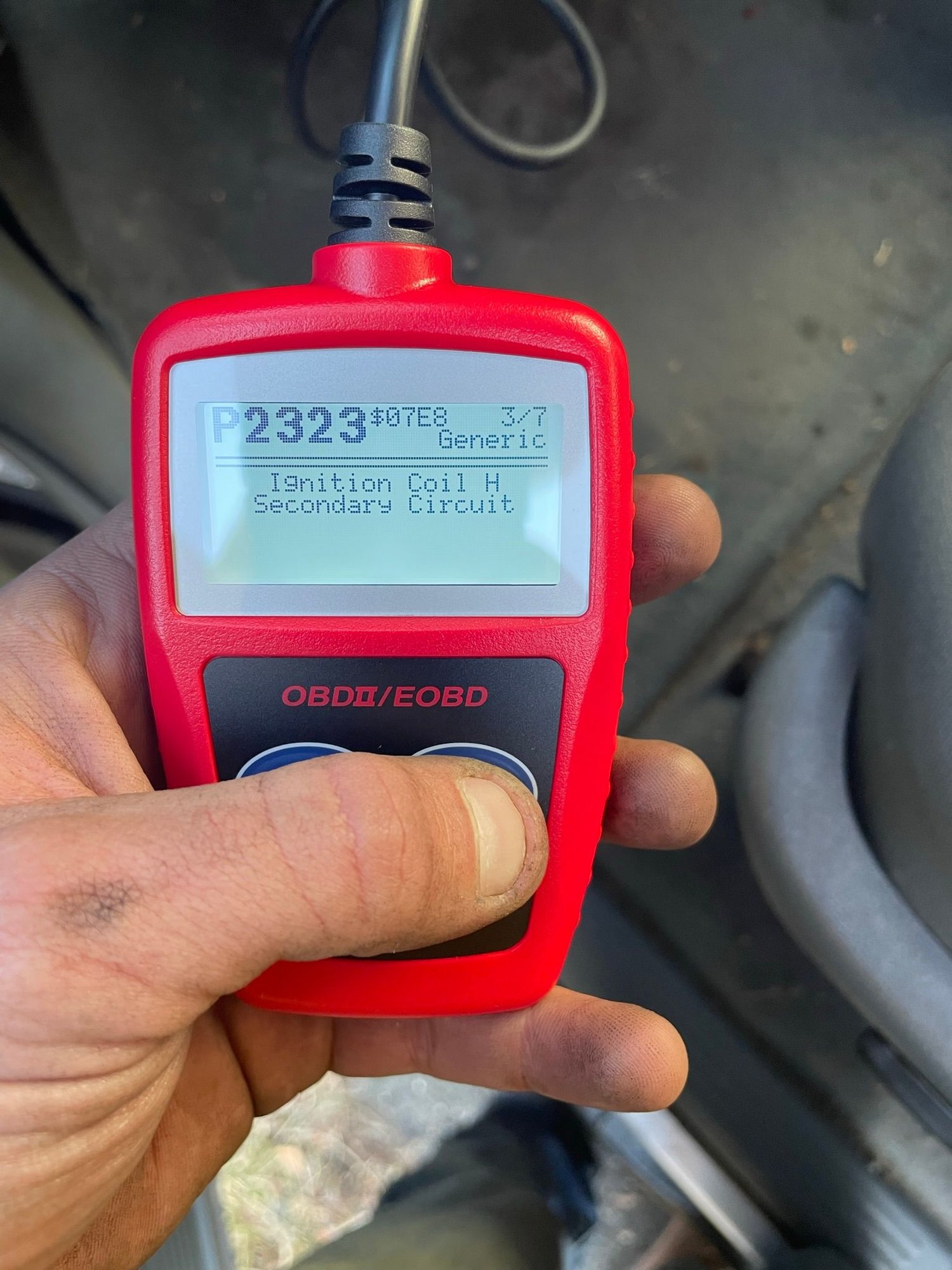

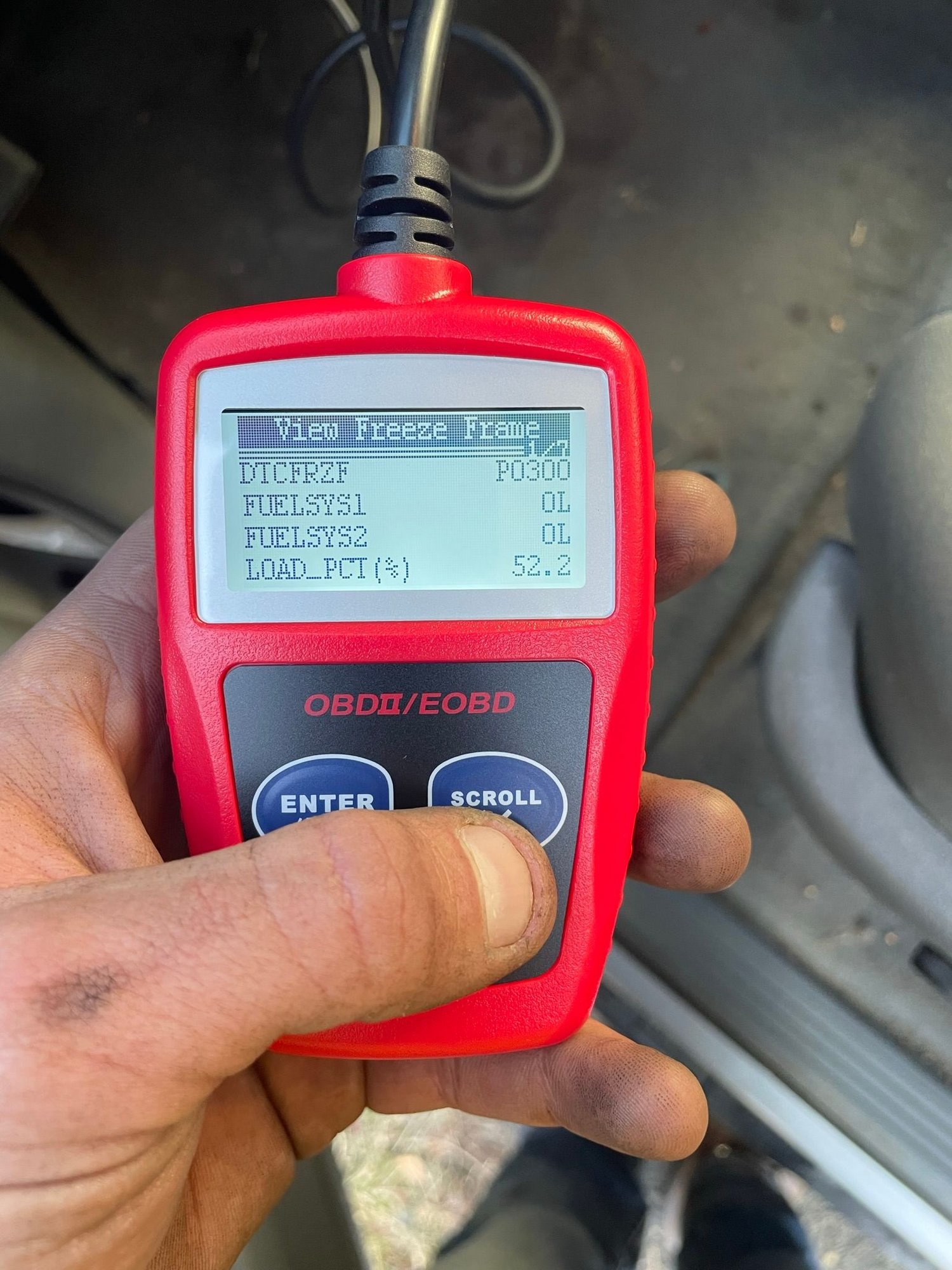

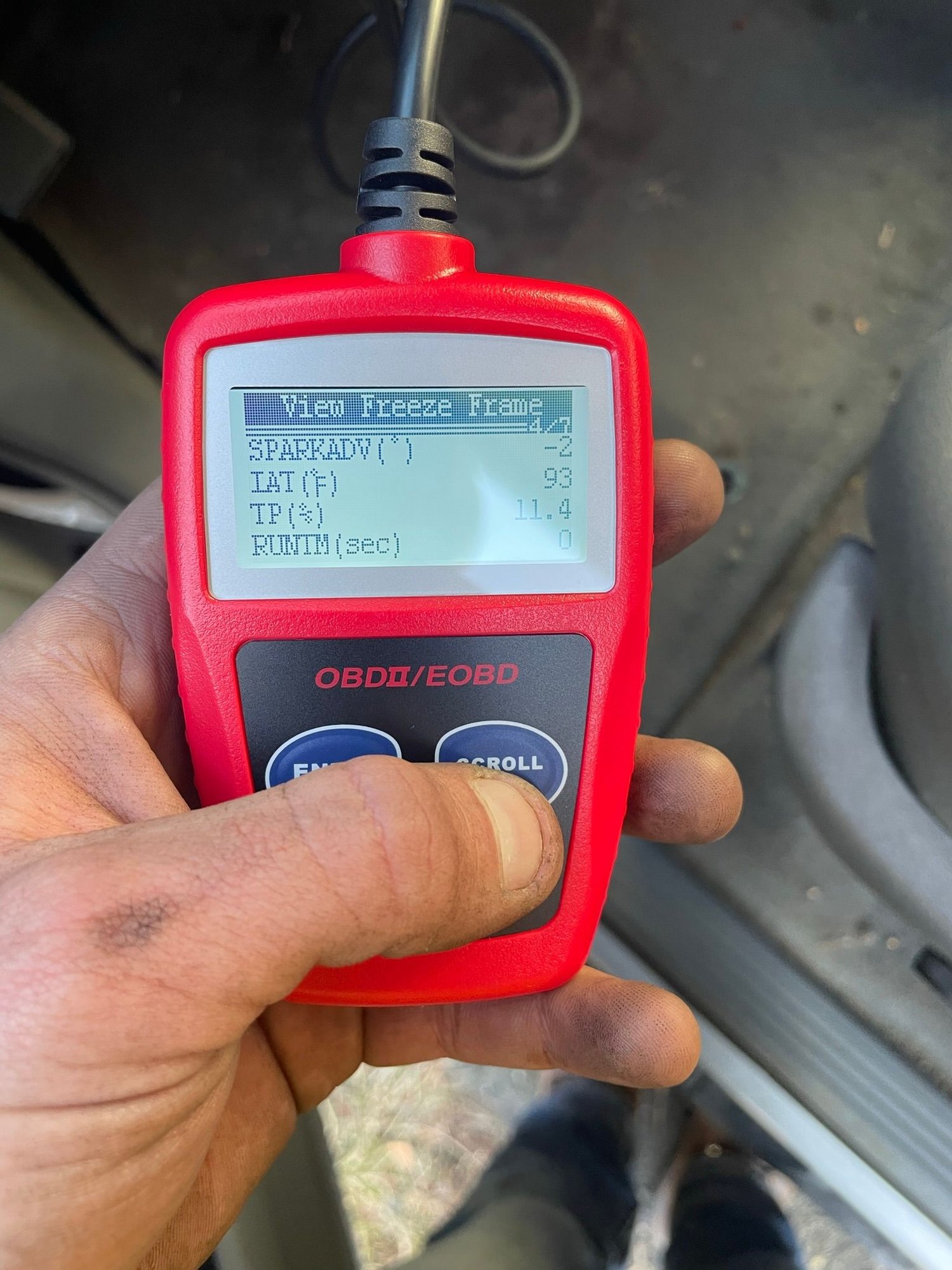

So after letting penitrating oil soak for a few days. I tried to use a #5 Spiral EZOUT with no sucess. Everytime i got a good bite on the plug, the #5 Spiral EZOUT would just slip off. I then added more penitrating oil and continued research. I found a great website that explained spiral EZOuts generally don't work. They suggested using a square EZOUT and it did the trick. Then i vaccumed out the cylinder and finished installing new plugs and ignition coils.
Went and started up the truck after my triumphant extraction of the broken plug. I now have 7 Error codes....(Keep in mind i started this because i had 1 code)
Codes include the following (I am new to using code readers FYI- i have OBDII/EOBD from walmart)
1/7: P0300 $07E8 Random/Multiple Cylider Misfire
2/7: P0308 $07E8 Cylinder 8 Misfire
3/7: P2323 $07E8 Ignition coil H Secondary Circut
4/7: P0113 $07E8 Intake air temp. sensor 1 Circut high
5/7: P0300 $07E8Pd Random/Multiple Cylider Misfire
6/7: P0308 $07E8Pd Cylinder 8 Misfire
7/7: P2323 $07E8Pd Ignition coil H Secondary Circut
I am fairly positive i didnt screw up installing the plugs or coils. Any help here would be nice. Please & Thank you!

The parts you installed are causing problems.
What plugs did you put in? Any rare earth plug can cause codes.
What is brand of coils you installed? Do you still have the old coils?
That half plug you extracted was cross-threaded and I suspect the threads in the head are damaged. What cylinder was that?

Iridium plugs have caused codes many times. I rec switch to copper plugs.
