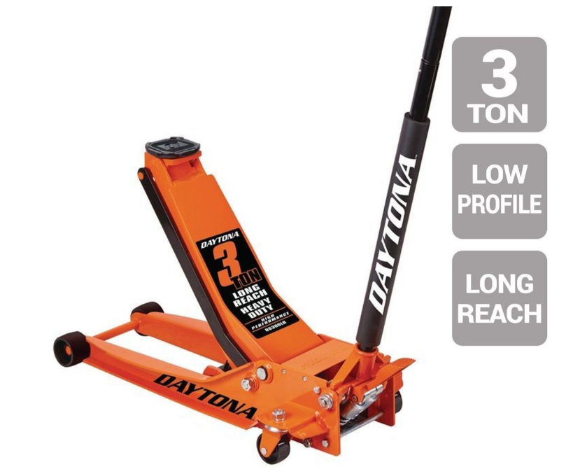

These HF jacks were getting good reviews a while back.
https://www.harborfreight.com/3-ton-...nge-64241.html
