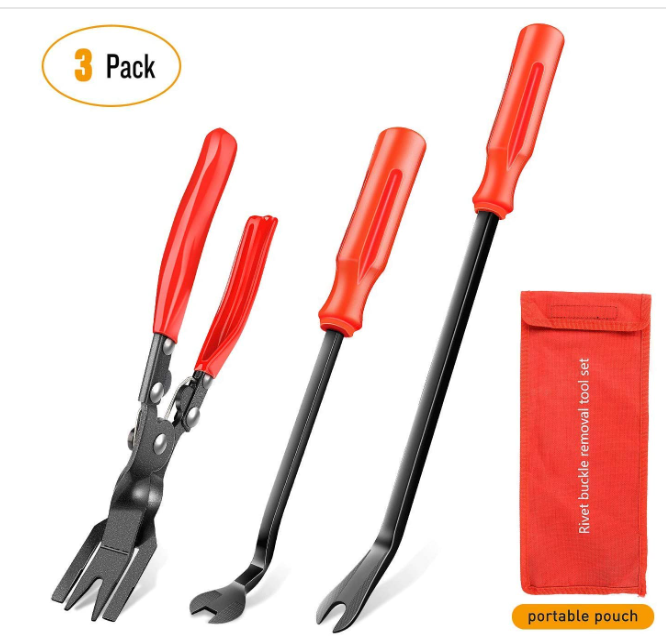

I think it'd be worth it, the bed is easy. Cab, as you suspect, more involved. Everything comes apart easily though, and a couple tools I like for harness removal below. I think I'd just swap the dash over wholesale, and while its out you can put in a new heater core and maybe replace all your vent doors. Make sure you add rust preventative to the list of chores on the new to you body :-) .
