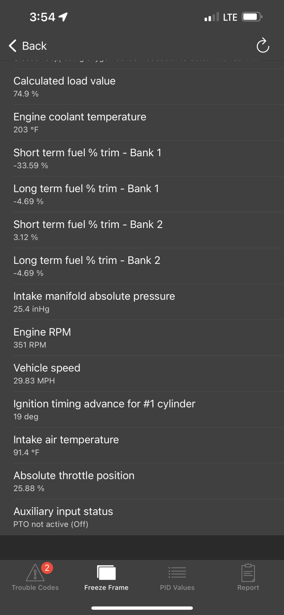

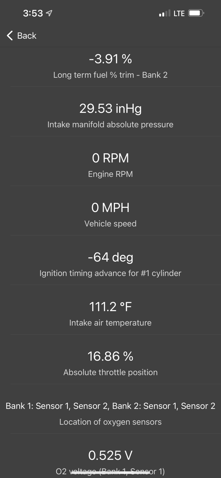

So
here’s what I found out. I can’t see crank position on it but it does show degrees of timing for #1. Not sure why one says 19 degrees and the other says -64. It did have a misfire on my way home and after about 30 seconds it was running fine. This is what I saw when I got home and hooked up the OBDII

Look at the bank 1 short fuel trim vs bank 2... bank 1 is leaning out big time, maybe due to a faulty o2 sensor on that bank? I'd swap the two front o2 sensors and see if the code fault follows - if it does, replace that o2 sensor with a NTK (mopars are picky about sensor brands).

I’ll have to give that a try. Maybe some bad wiring right there causing it to be intermittent… I have checked fuel pressure on the right rail and it was good but I don’t ever get a chance to when it is missing.
