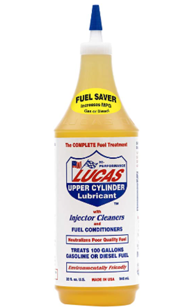

Seafoam won't hurt, but it probably won't do much good either. I'd save your money and just run some lucas upper cylinder lubricant in the fuel tank - along with a couple full tanks of super. After you do the plugs and get the new fuel in there, pull the battery to reset the computer. I suspect its already made alot of adjustments due to wrong gap, wrong plug, and the resulting build up. I'd drive it like you stole it for a couple hundred miles, that'll help clean out the combustion chambers. It'll probably run like a new truck by the time you're fueling up the 3rd time.

On this last tank before I changed the plugs I put a bottle of Lucas injector cleaner in it. I changed them Friday and then took it for a drive. It ran great, better than it had in a while. Went to go this morning and it started having a multiple cylinder misfire again. I put in the copper champion 570 at the right gap. It’s not throwing any other codes.
