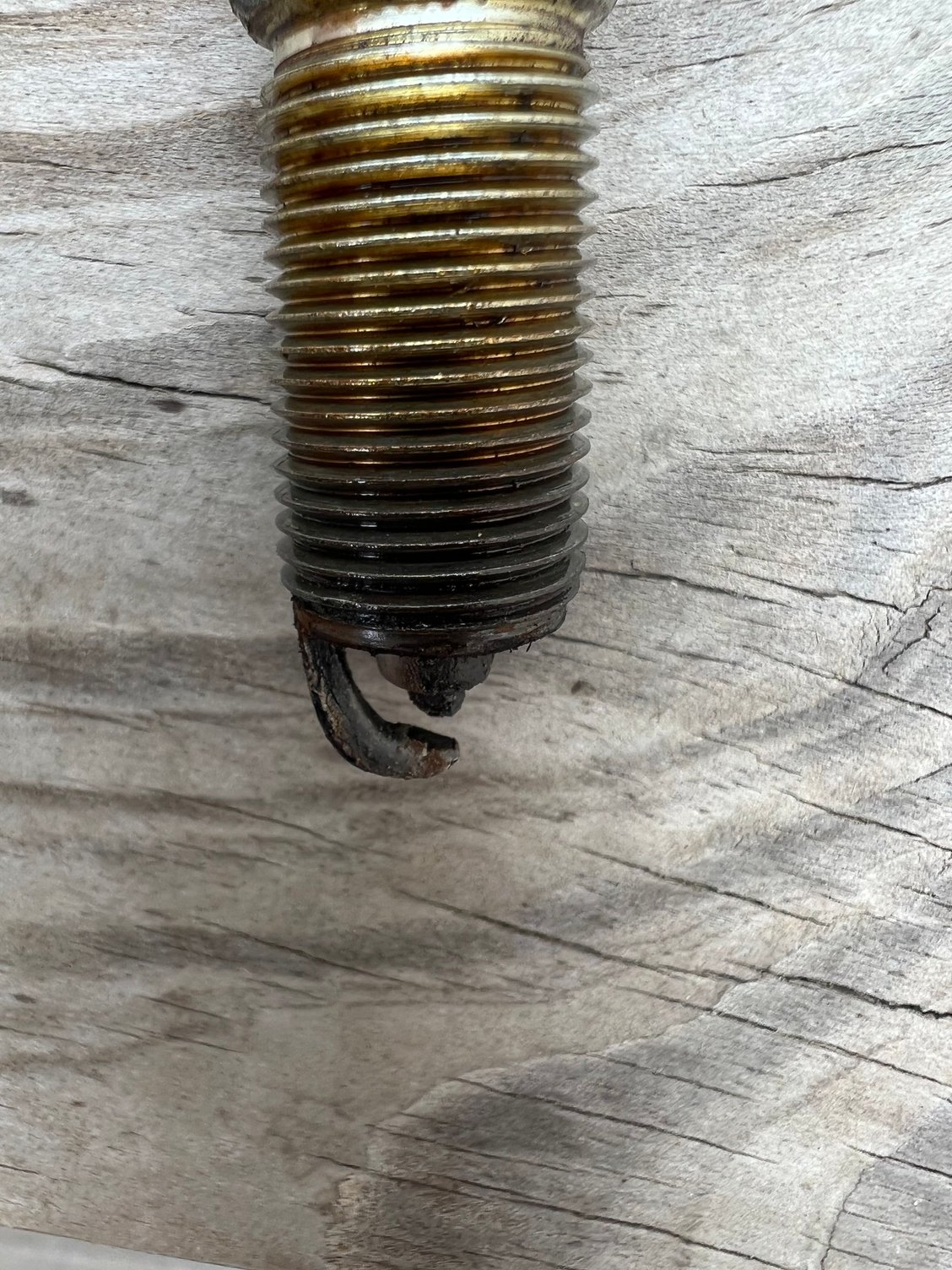

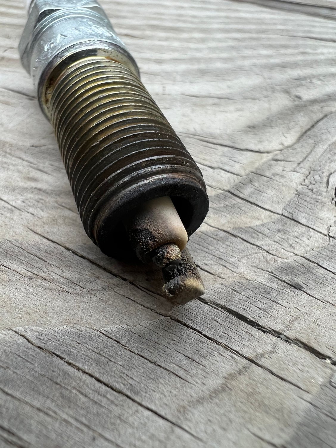

Old May 4, 2022 | 05:00 PM
Colbymason1's Avatar
Colbymason1
Joined: May 2022
Posts: 17
It’s got the Champion 3570s in it. Platinum plugs not copper. Might be time for a change…
Old May 4, 2022 | 06:06 PM
Posts: 87,461
Likes: 4,219
Yep, put in standard copper plugs. I think you will find your problems go away.
Old May 5, 2022 | 08:01 AM
jrsick's Avatar
jrsick
Joined: Mar 2006
Posts: 833
Likes: 68
From: Chesapeake, VA
Those are probably the original plugs. You've got some carbon fouling, but that is probably because the gap is about .80.
