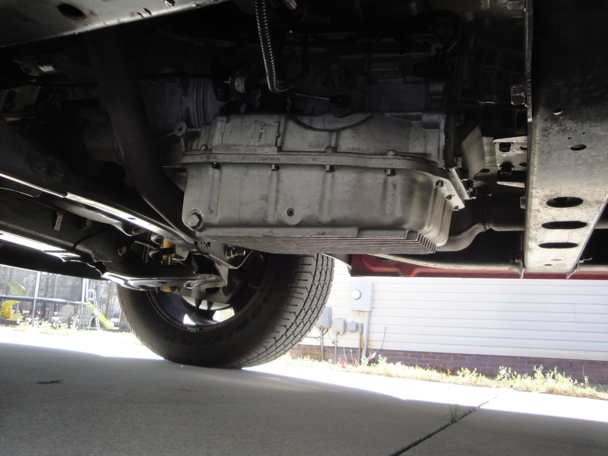

It's part number 52029089AB. Also a finned trans pan doesn't hurt either:
