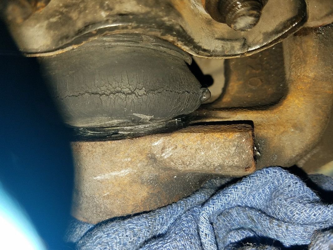

This probably won't help you right now, but maybe if you see a split forming on the next one, or any cracking rubber....
I had put in some cheap greasable NAPA ball joints which were fine for a few years, then the cheap rubber start cracking all over. Next time I put grease in, it starting coming out the cracks. Look at the right side and you'll see it oozing out.

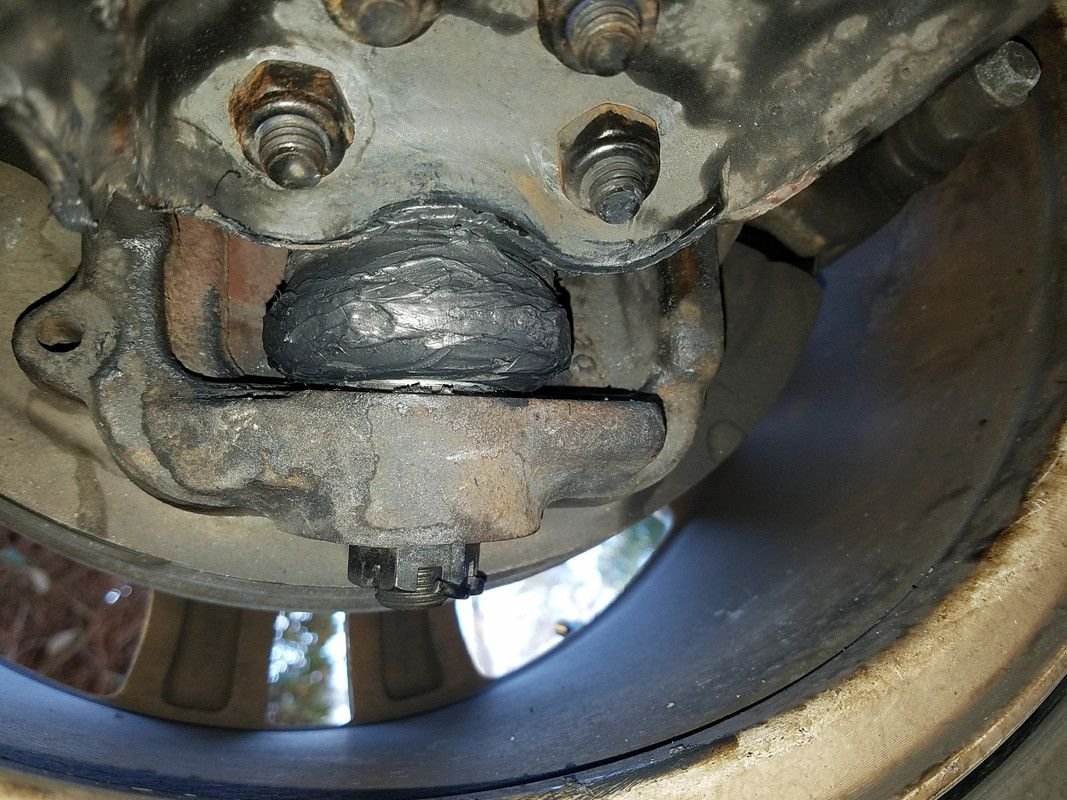

Well, I didn't wanna replace ball joints and pay for an alignment again... so necessity being the mother of invention, my cheap azz thought about that tube of Permatex Black (oil resistant) RTV, that was drying up. I cleaned the rubber with brake clean, then applied a few coats, letting each coat dry (somewhat) in between. Amazing how strong the rubber is now. I put a heavy bead around the circumference where you saw the most cracking. The dried Permatex is way stronger than the original rubber. No more cracks or leaking years later.
