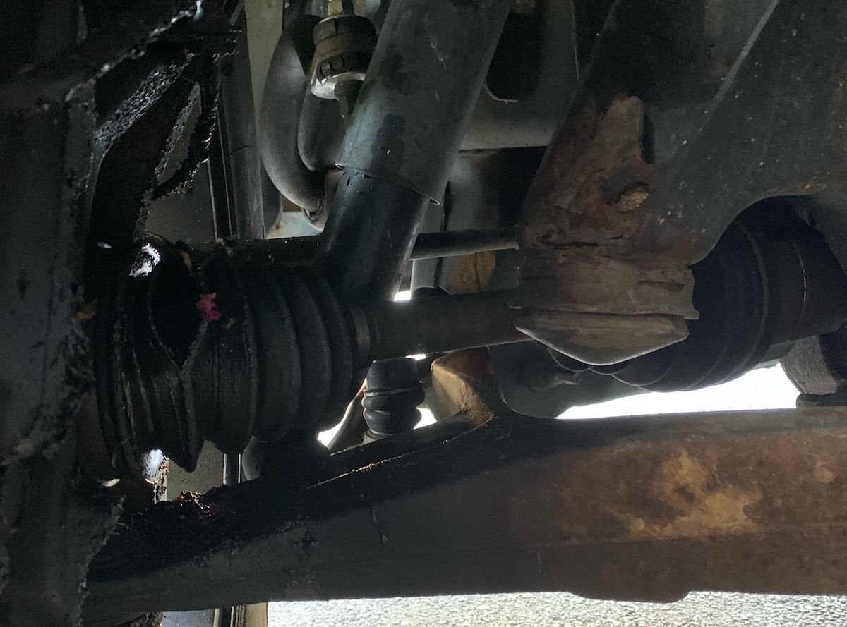

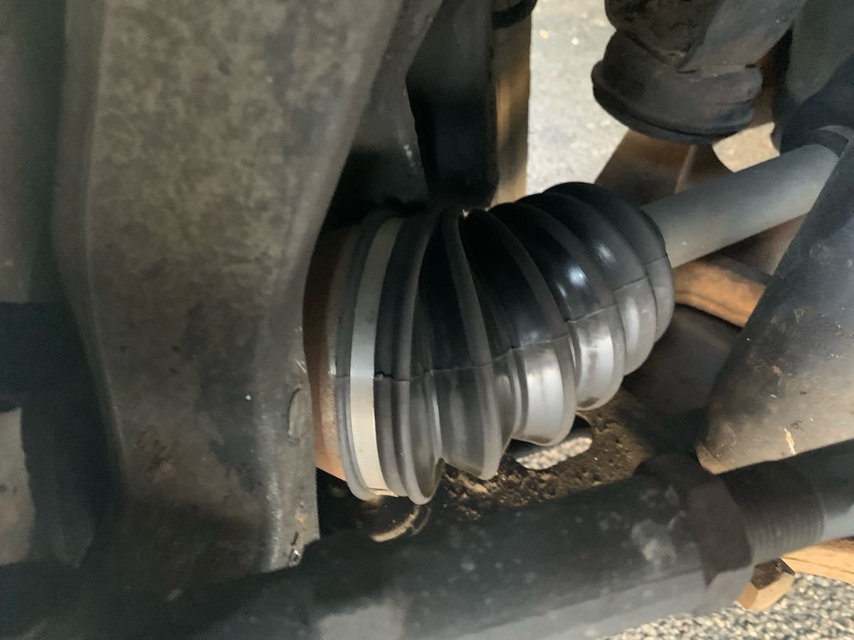

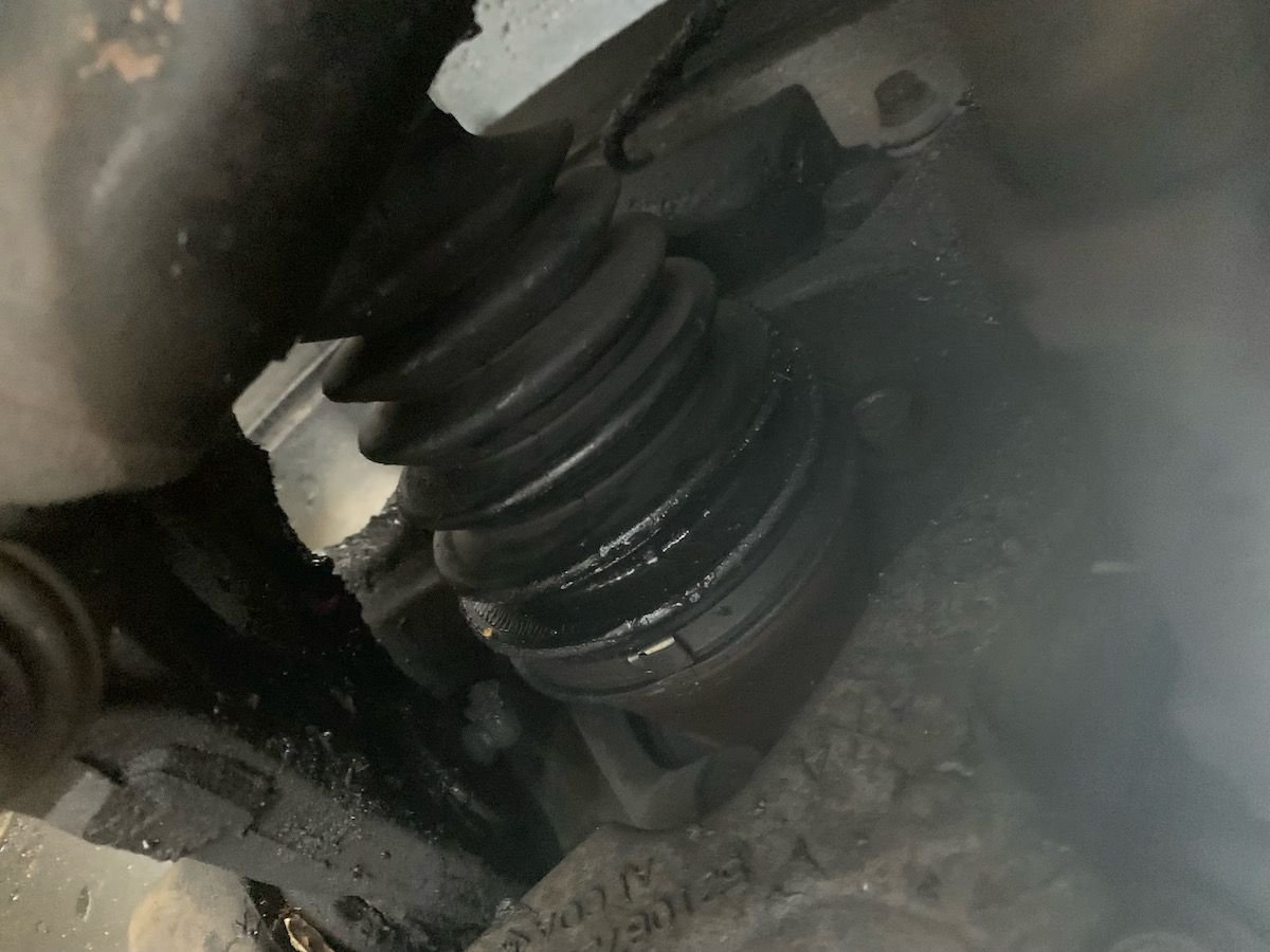

I have put in 3 front axles in a short amount of time because the boots keep splitting. I have no idea why this is happening, I don't have any leveling or lift kit added and its all stock suspension. Removing them has been a nightmare each time, so I'd rather not have to keep doing this, plus the $100 or so for the part.
The only change to the truck is I replaced the stock 18"? wheels with 20" wheels from a later model Ram. This maybe lifted the tuck 1" or so I'm guessing with wheel height not being that different (I don't believe) the axle shaft maybe sits at 5 degrees give or take, nothing extreme.
Any insight on why this is happening would be great. I don't go off-road and it sees mostly highway miles because I work from home and use it to get groceries or to drag my kayak to the boat ramp.
Driver side turned front view
Driver side turned back view
Driver side wheel straight
Passenger side turned front view
Passenger side turned back view

Maybe the boots are low quality? They sell these split boots you can look into.... this is just an example so search for your model....
That is most likely the case... but here's the history:
Original boot splits on drivers side with over 200k miles on the truck - Advance replacement axle put in on both sides assuming the other would go soon.
Less than 12 months later Drivers side splits again. Advance replaces with new axle, previous brand discontinued.
12 months later Passenger side splits - replaced with same part from Advance
3 months from that point - Drivers side again splits.
I am thinking trying those universal split boots - can't be any worse than the $140 axles that are failing every so many months and that would be worse if I my son wasn't a mechanic and I had to pay labor.

If there isn't any obvious signs of something contacting the boot, (and I don't see any), gotta be poor quality boots. They last just long enough for the warranty to expire..... then fail. Maybe an axle from a better quality manufacturer?? Though, I would hate to think how much Mopar wants for 'em.....
