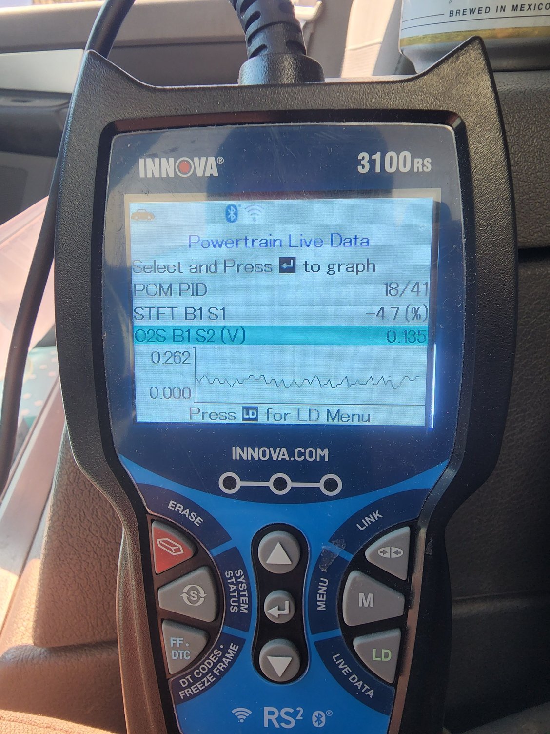

I'm just looking to get a smog check. I recently had my vehicle as planned non operational due to a check engine light. Recently I've been fixing the truck and have replaced the catalytic converters and the 02 sensors. I have also replaced the EGR valve, the MAP sensor, the IAT, and all spark plugs as well as the boots. Yes, I also replaced the ECM. Still catching the same 1128/1129 closed loop fueling not achieved bank 1 and bank 2 o2 sensors. Honestly the truck is running great with 302k/mi. It has the 4.7l JASPER swap per the dealer on a warranty. I open for suggestions, or even wiring diagrams because I'm about all out of ideas. I hooked up multiple scanners just to collect the data. I'm willing to share the specs. Thanks, God Bless!

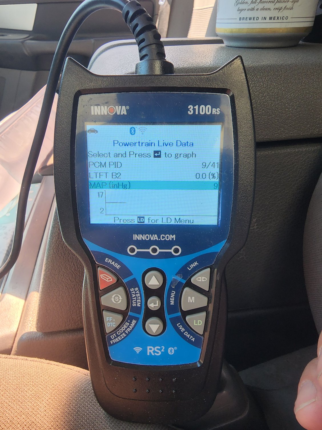

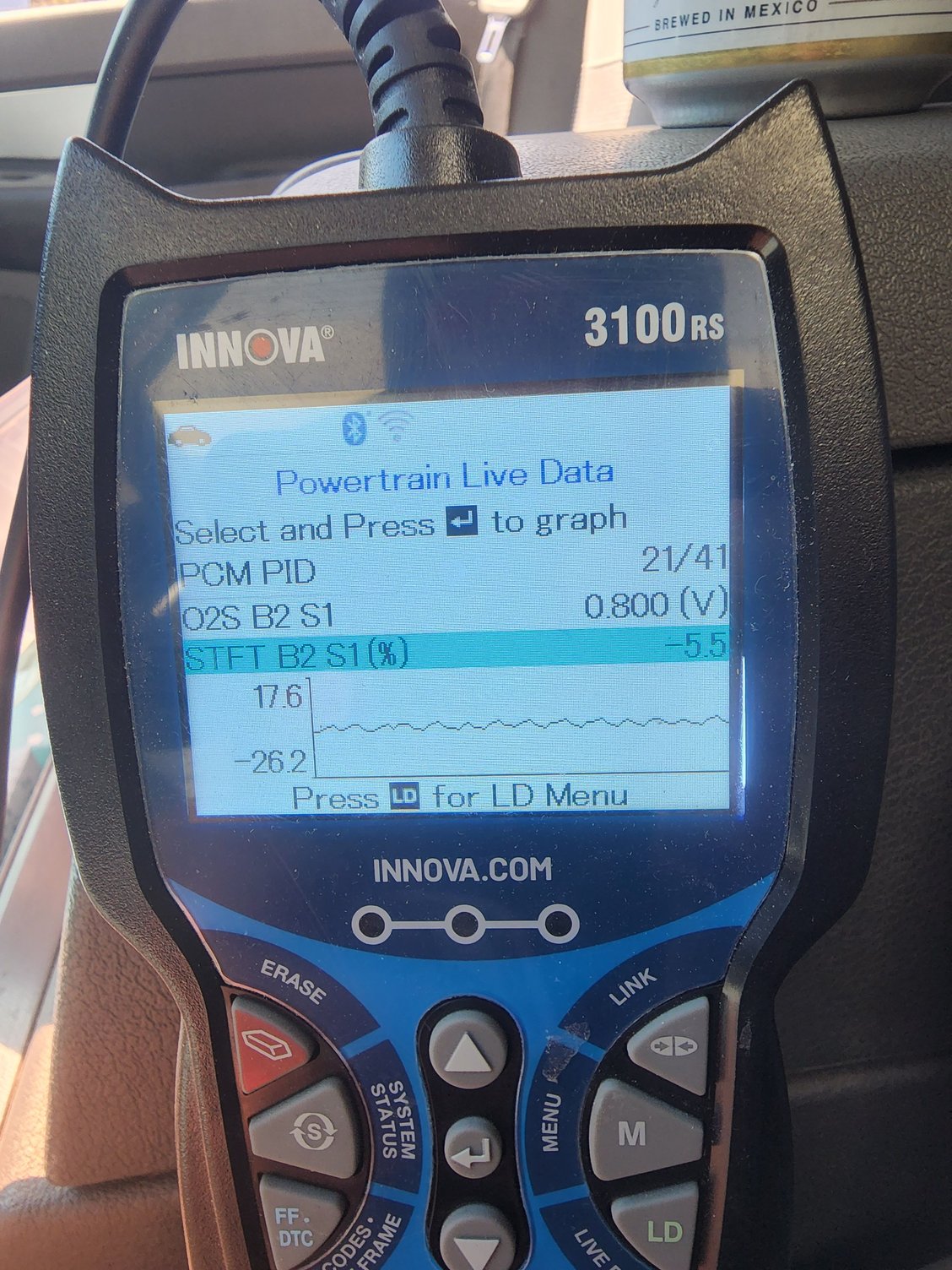

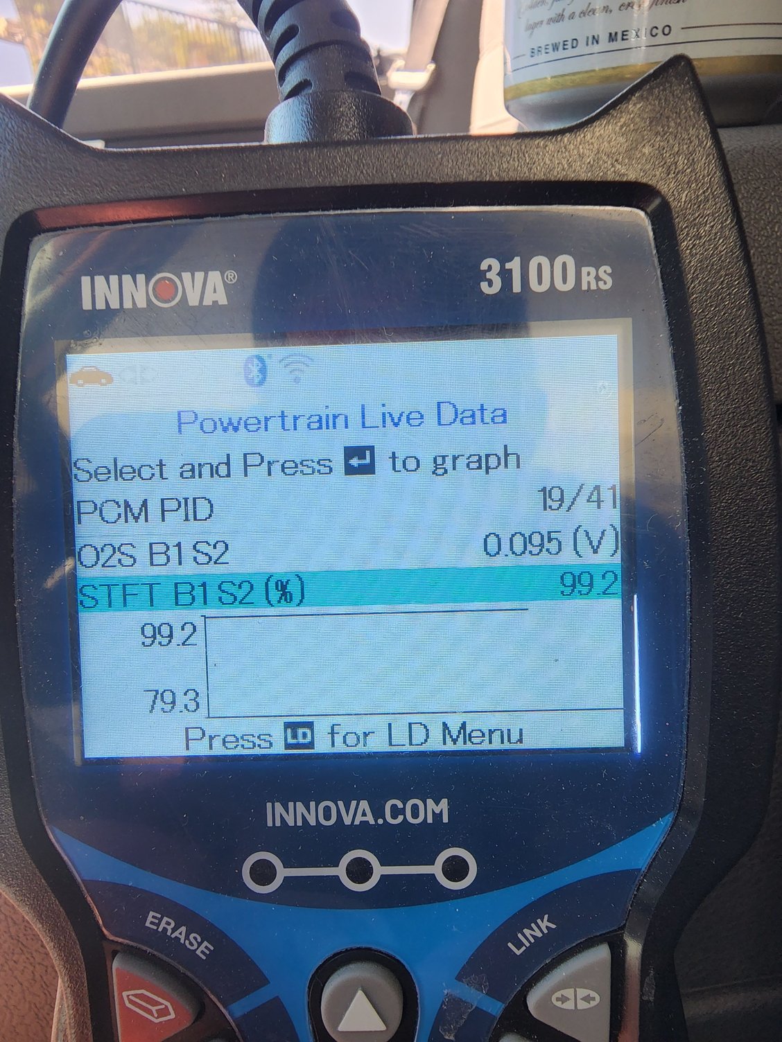

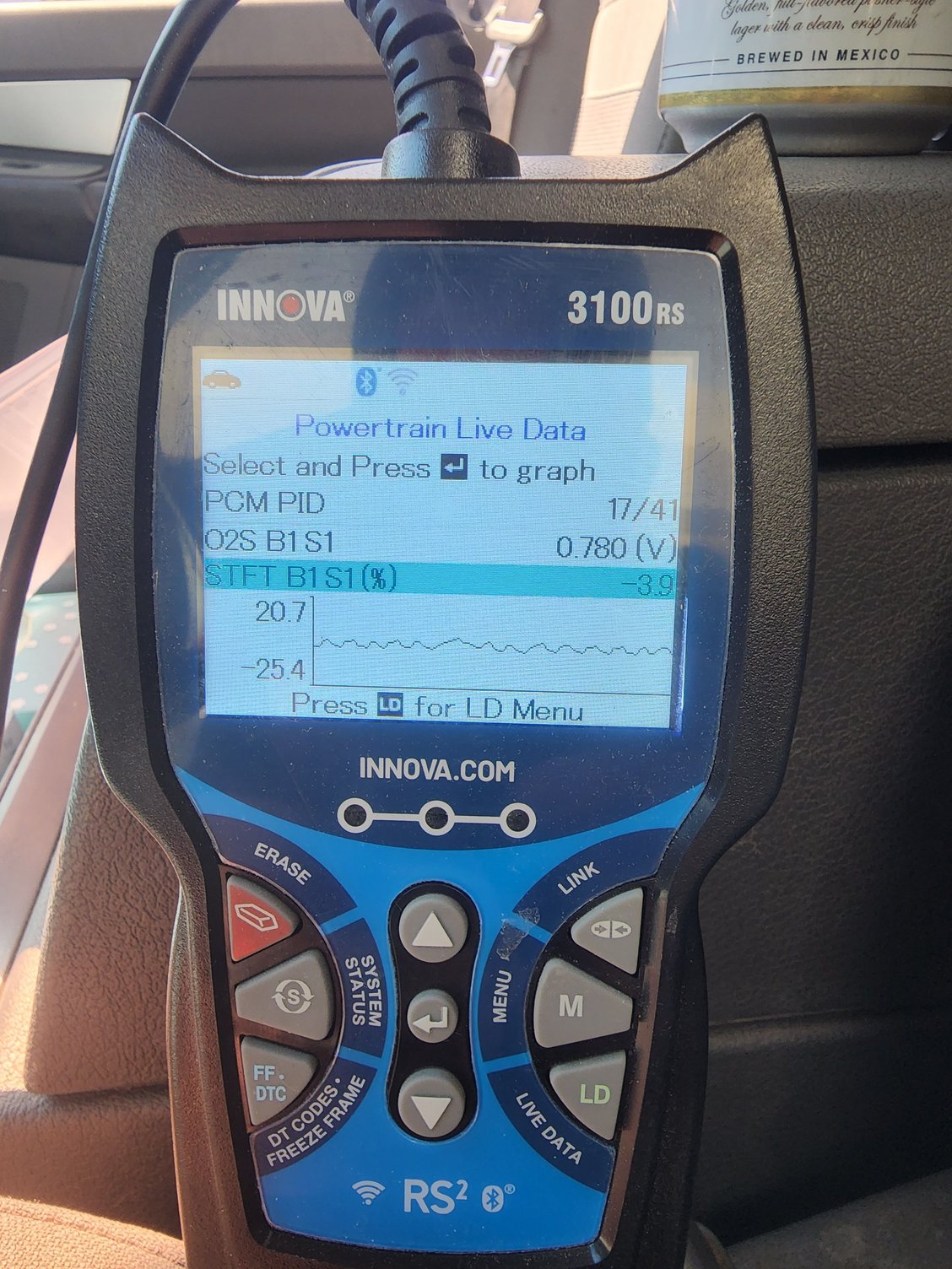

yes I have a live data read scanner. I took all the pictures I thought I would need too. Ran the truck for 10min and got pictures

Something is up on bank 1. The graph for O2 sensor voltage is not what I would expect. (sensor 1) Should look more like bank 2 sensor 1.
Any misfires showing up? Bank 1 is running REALLY lean.
