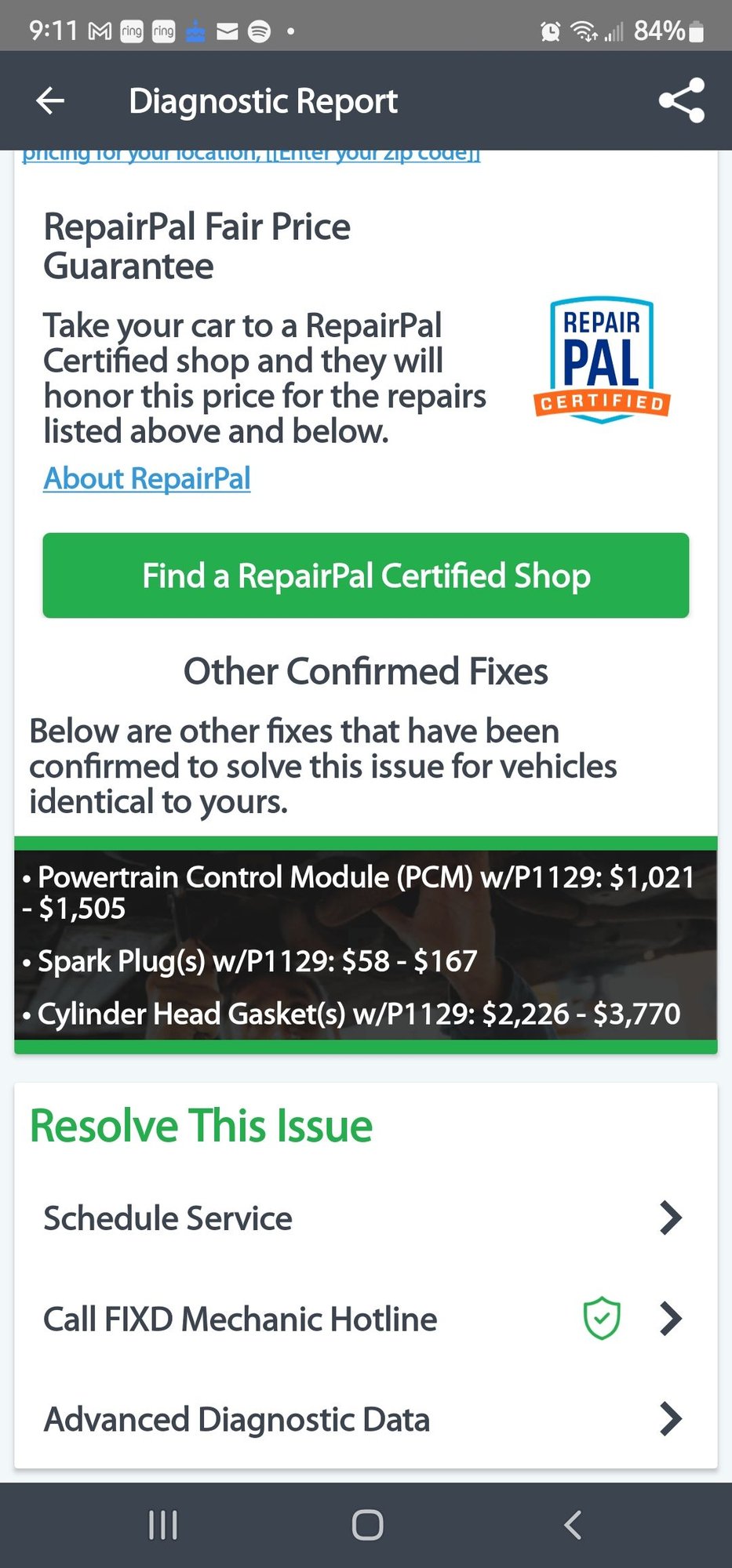

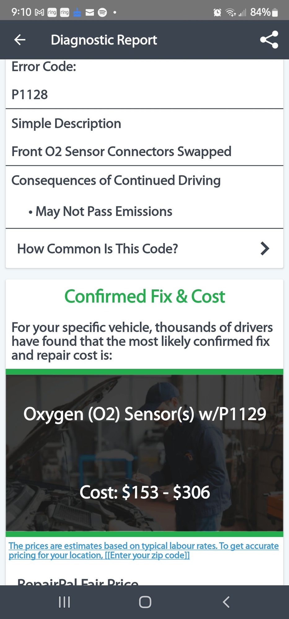

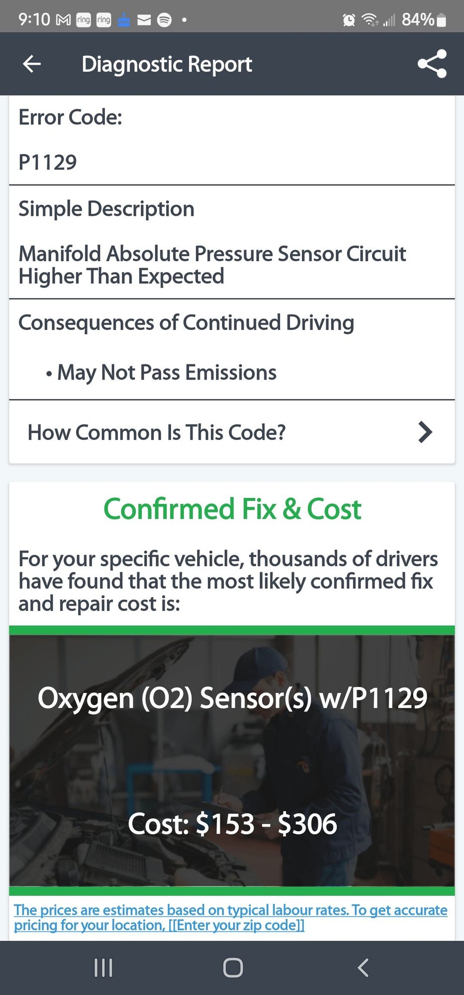

Something is up on bank 1. The graph for O2 sensor voltage is not what I would expect. (sensor 1) Should look more like bank 2 sensor 1.
Any misfires showing up? Bank 1 is running REALLY lean.
no misfires that's I've seen. These are what FIXD app and Innova 3100RS scanners show.
FIXD:
This is INNOVA 3100RS
Old Aug 14, 2022 | 12:30 PM
Posts: 87,479
Ah, so the PCM is thinking S1 and S2 are swapped, not left to right. Looking at the readings, that is a reasonable conclusion. Where are the connectors for those two?

Moving the sensors from hole to hole won't matter, if the sensor itself is ok. It's the other end, the connector, that the PCM is whining about. It seems to think you have sensor 2 plugged in to where sensor 1 should be, and vice versa.
