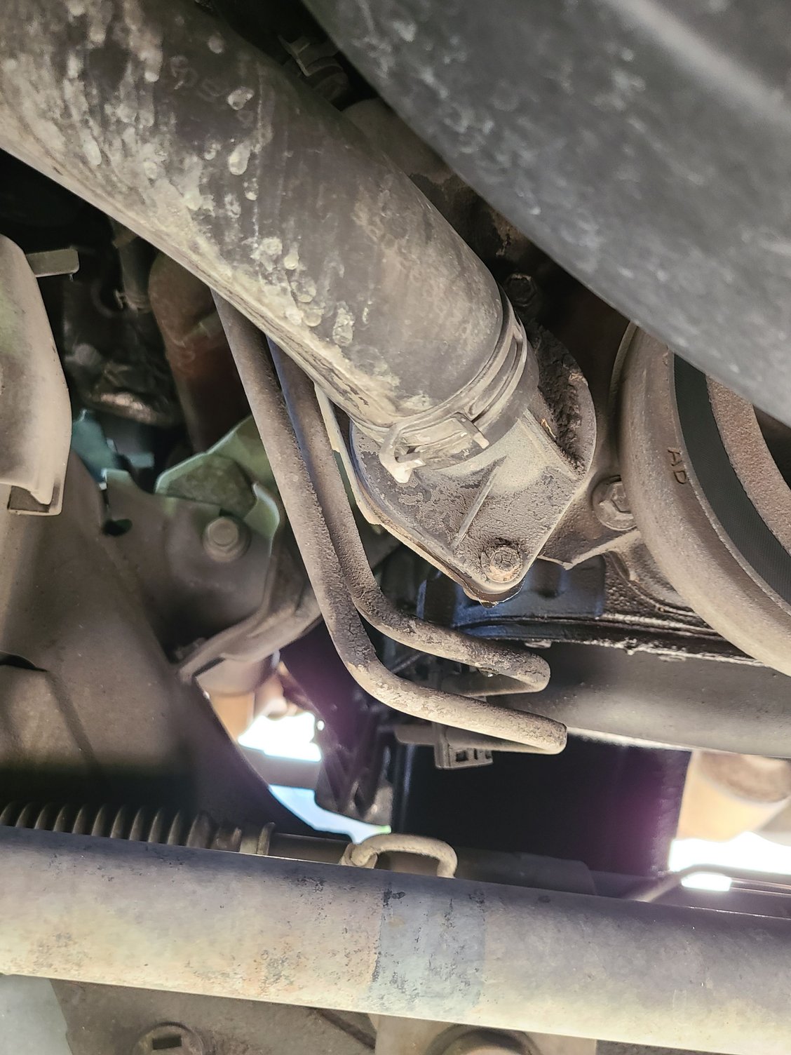

Need help identifying if this coolant outlet/inlet housing has gasket or uses some sort of sealant. Its the one at the bottom of engine that connects the lower radiator hose. Its leaking really bad from there and couldn't find any information on this repair or part numbers. I really appreciate the help . Im new member and owner of this truck.

Hhhhmmm.... Not find a good diagram of parts, can you post a pic of it?

Another pic from your Amazon link. You can see the gasket there. A new thermostat will come with the gasket. Don't break the bolts. Oh and don't buy Dorman junk if you do get a housing. Mopar part #
53020887AD

You may want to check torque on the bolts, 112 inch/pounds.

Does this connection also house a thermostat? Also i do notice it does have some sort of thin metal gasket of some sorts. Couldn't find any information or part number for that either.

Are the pictures not big enough?
