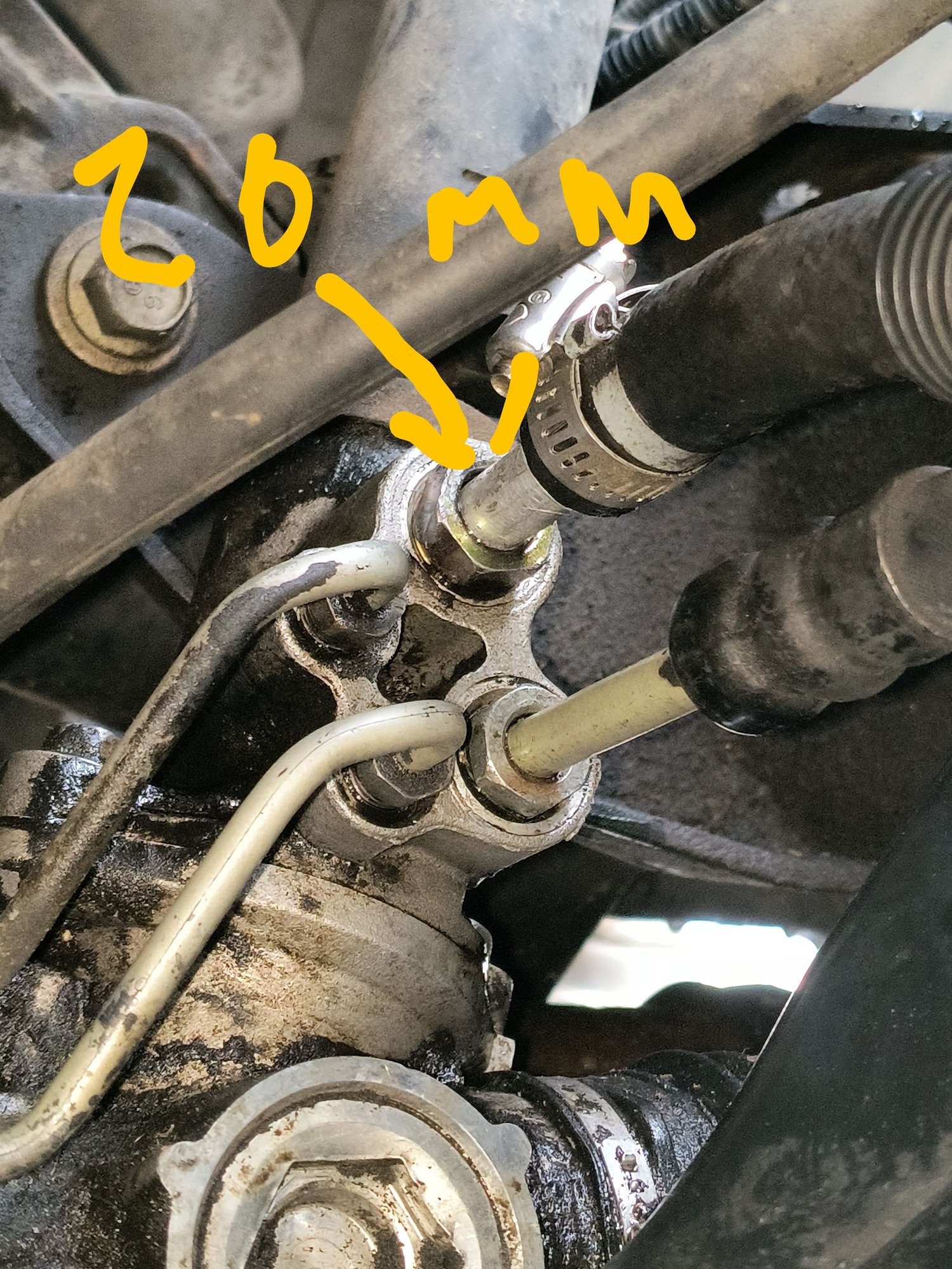

Default Pics
Here's a picture. The top nut is the gearbox to cooler line, low pressure, and is a 20mm nut. The new hose is a 22mm nut. I found the leak, a drip, at the gear box end near the oem clamp. I decided to put a hose clamp, shown in pic, and it pretty much eliminated the leak. I tried pb blaster soaking overnight, tapping the nut lightly, etc. Etc. And it won't budge. I can order a 20mm crowsfoot flare wrench for $16 so I might try that. I also wondered about just cutting the old hose off the metal piece that goes into the gear box, get a new piece of hose, and clamp over the metal piece. Scared to fool with that nut if the leak is tiny. If I mess up, its a new gearbox. Any other ideas? Thanks.

I also saw a video where the guy cut off the metal pipe near the nut and then used a six side socket to remove it. I wondered if that might get metal inside the pipe and then into the gearbox which might get in the system? That wouldn't be good.
Old Jan 18, 2023 | 06:01 PM
Posts: 87,482
If you cut it with a hack saw, or cut off wheel, yeah, likely gonna get some debris in there. Now, use some side cuts, and it should be less of an issue.
