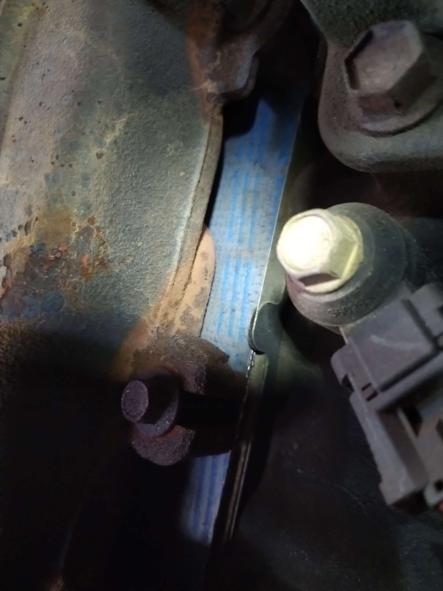

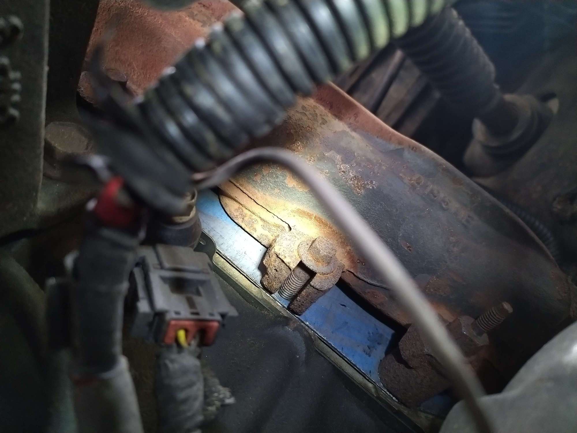

Well the exhaust shop is too busy to help me out until Monday, so I decided to take a moment and look over the manifolds with a flashlight, and am I crazy or does this look like it's separating from the mating surface of the cylinder head?
Middle of the driver side exhaust manifold, hard to get an angle but I can see pretty far into it.
Middle of the passenger side exhaust manifold, doesn't look as significant as driver side.

Old May 5, 2023 | 01:51 PM
Posts: 87,479
Got any feeler gauges? If you do, see if you can stick a skinny one in there.
I agree though, that doesn't really look quite right. But, if it were leaking, you would see burn marks on the gasket there.... I would think.....
I thought so too, my last leak had carbon marks... I apparently lost my feeler gauge so I tried using a piece of paper and I could get it a little bit of the way in but it would stop, so I'm not really sure what's going on there. Maybe I can blow air into the exhaust with an air compressor and see if I can get air blowing out of it, but the muffler has so many holes in it I feel it'd all just leak out there . I'll probably just wait until Monday when the local exhaust guy can help.
