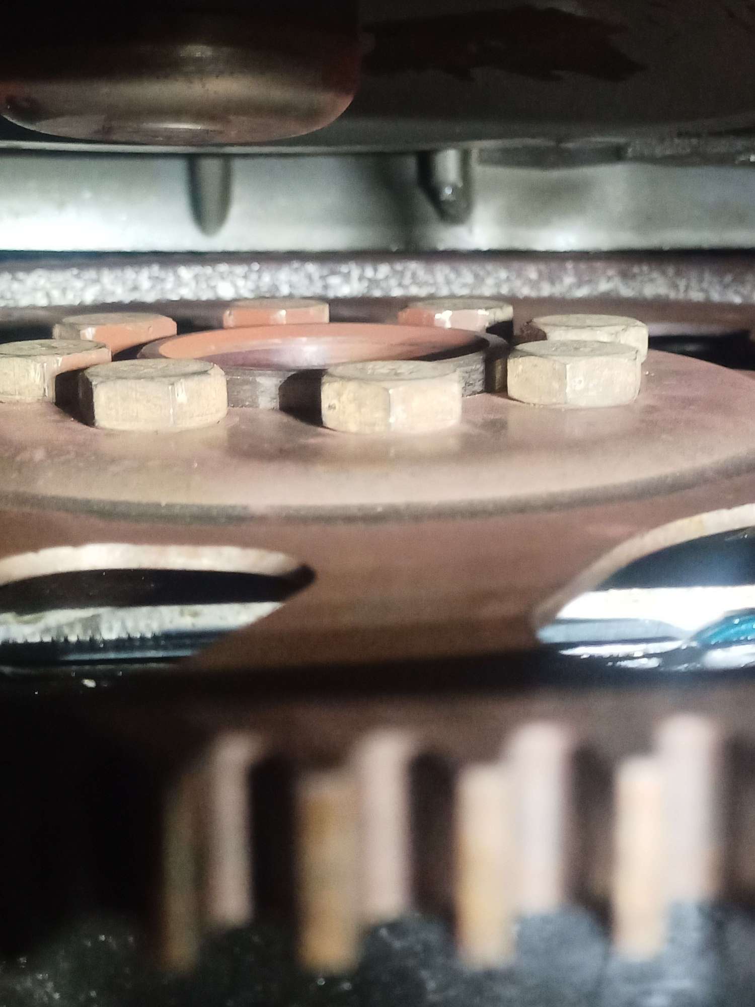

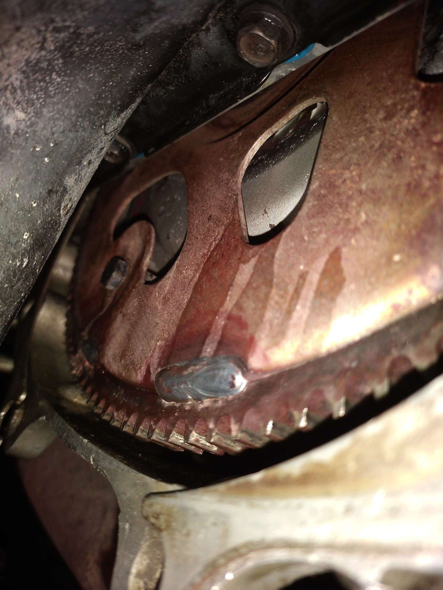

I think I've had sort of a breakthrough with the hose method considering what the exhaust guy said, if I put it right against the area where the engine mounts to the transmission I can hear it, only if I do it from the engine side though right at the back of the oil pan, around the flexplate area. But I've inspected the flexplate and it didn't seem damaged/loose/cracked/any bolts missing... It also seems straight and doesn't waver when the engine is running. I asked a mechanic friend about it and he told me that it can have micro cracks that you can't really see unless if you hold it up to the light to see, which I did not do, not sure how true that is.
Got some photos of the mounting points
One side..
180 degrees on the other side..
Old May 8, 2023 | 05:46 PM
  #26
Posts: 87,482
I don't see anything wrong there...... there any shiny spots on the flexplate anywhere??

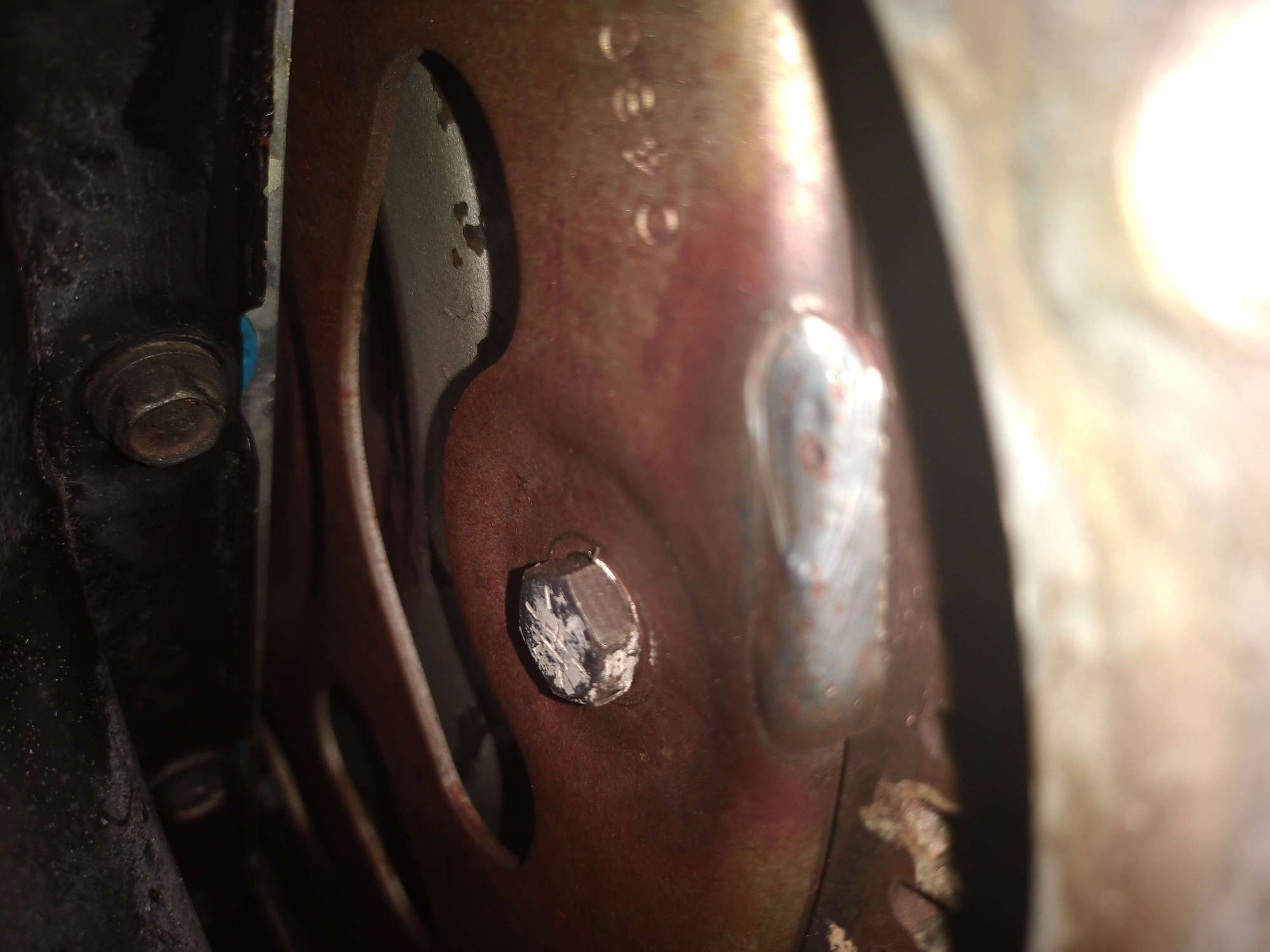

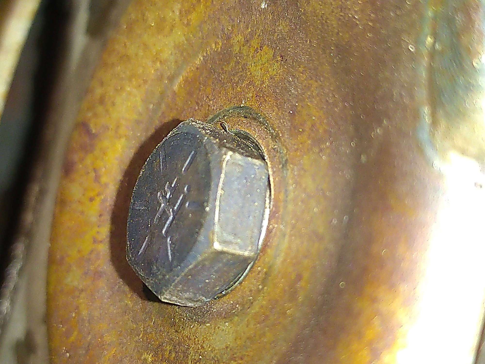

Okay, after fumbling around underneath the truck for a while and cleaning some stuff up (rear main seal's been leaking for a while), the noise is definitely louder with the inspection cover off, and when I use the hose trick it's right on the flexplate, not sure if it's louder around the TC bolts or the FP bolts, just kinda all over.. Would make sense why I couldn't find the noise if it was buried in the bellhousing.
I can't really find anything visually wrong with the bolts or mounting points, is there a certain procedure to bolt up the TC that I may be unaware or a certain orientation to the bolts? I didn't think about it before but these bolts never had washers on them. They're all tight and have threadlocker on them. Flexplate doesn't wobble or seem loose, even when prying it gently with a screwdriver.
Right at startup. Sound is there then it goes away.
https://youtube.com/shorts/WKW8eb-ta30 Hot idle.
Bolt looks okay, the shiny circle around the bolt is when I tightened it down with a socket when I originally reinstalled it.
The wet spots is brake parts cleaner overspray from me trying to wipe away a lot of oil residue. FP looks fine and no shiny spots all around.
This bolt *maybe* looks slightly uncentered a little to the left??

I can hear something, but, no clue what it could be.
The bolt being not quite centered is ok. They likely all look like that.
