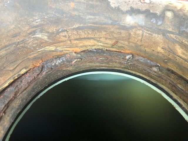

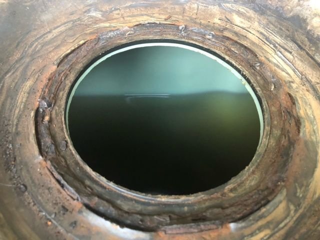

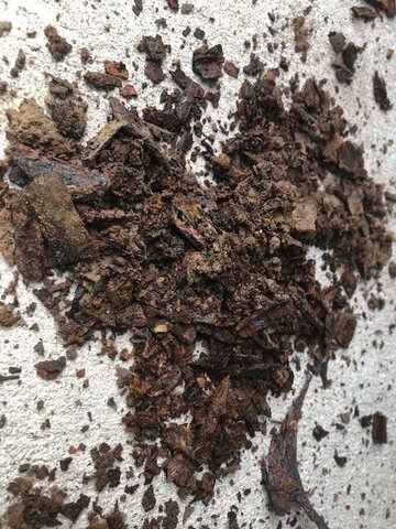

My '06 Ram 1500 started throwing a "gascap" code in the odometer display and started running rough at low rpms. After a quick investigation I found that the fuel pump assembly was just sitting in the tank and the lock ring that holds it in had completely rotted away. I got the tank out and now have to figure out if I can just replace the lock ring or if the tank itself is beyond saving. There is some metal material at the top of the tank still, I can't tell for sure but it looks like what's left on the tank was what the lock ring would have attached to?
I attached some pictures of the tank and what was left of the lock ring.

There is a recent thread in the Van section for just such a problem. That member got a 'lock ring repair kit' that solves this particular issue.

Thank you sir! I found the thread here: https://dodgeforum.com/forum/3rd-gen...acement-2.html. I'll check out the repair kit or try something similar with a replacement Mopar lock ring. I love the ingenuity!

That’s my thread. You’ve already done the hard part- dropping the tank and cleaning it out. Order the kit. You’ll spend $65.00 and you’ll fix the issue without a doubt.
Yours looks worse than mine did, which in this case is a good thing. You hardly have any of the locking studs left so it won’t take long to grind them down so the ring fits flush. I ran a bead of sealant outboard and inboard of the screw holes to ensure it would be sealed well, used a 1/8” drill bit to drill pilot holes, filled the holes with sealant and applied sealant to the threads of the self-tapping screws before installing. Once the pump was installed and the screws torqued, I ran a bead of sealant around the outer edge of the ring and tank surface. It does not leak!
