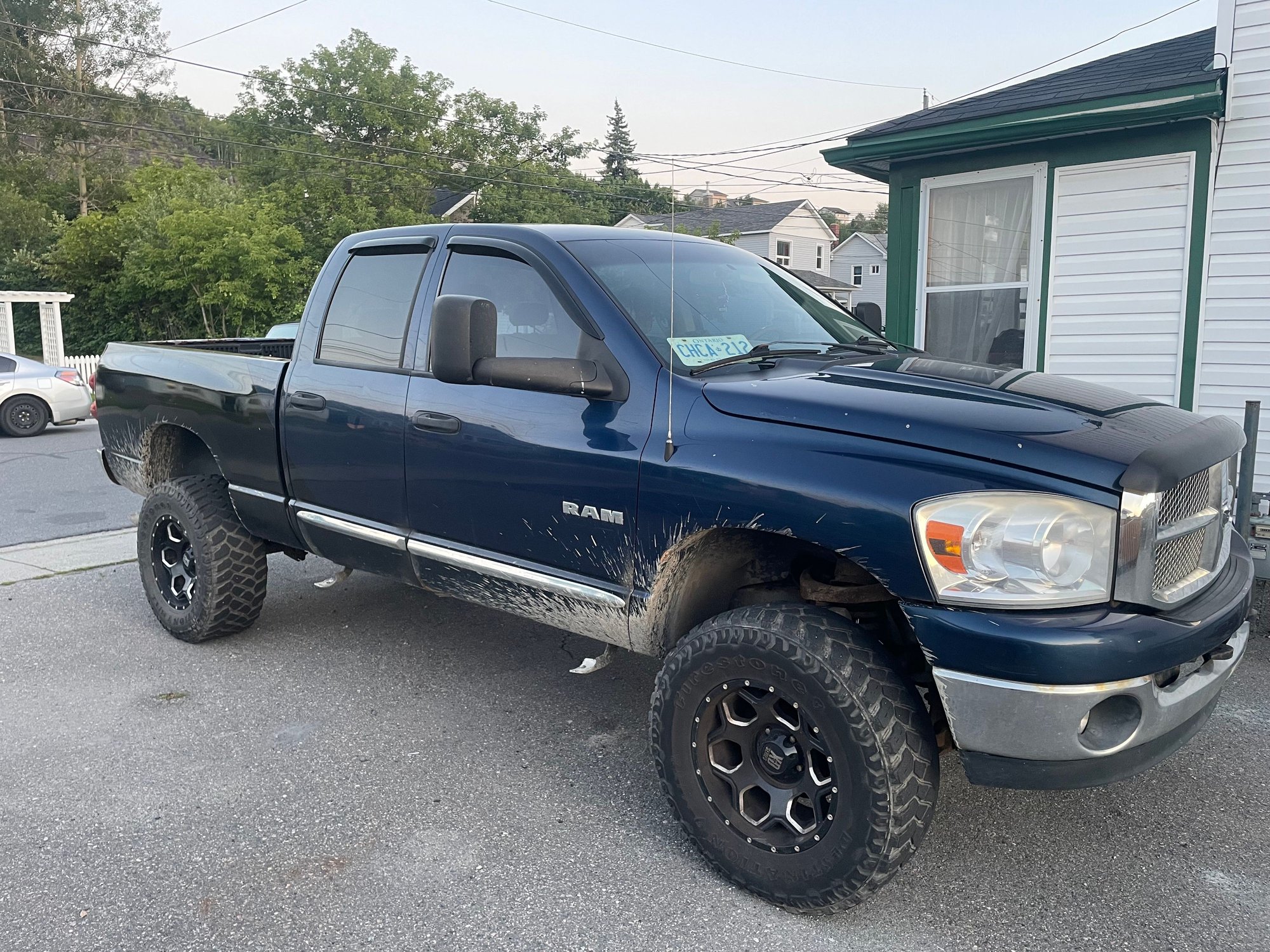

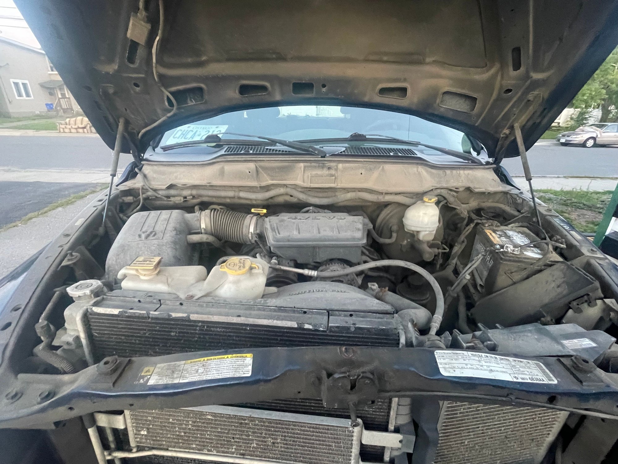

I just picked myself up an 08 with the magnum 4.7L V8. I’ve driven it a few times and it feels like it has nice power and no bad noises so far. But I haven’t heard too many good things about the engine and I would like to know other options.
At the end of the day the truck has 245,000km (150,000 miles) and I’m not sure how well the last owner took care of her so the engine may not be long for this world.
Anyway I was wondering if the stock transmission and ECU/electronics are compatible with a 2011 5.7L Hemi without major modifications. As one of my local used part stores has a couple

If the truck was taken care of, the engine will treat you well. It was mainly those that weren't maintained which were bad and gained a bad reputation. The issue with going from a 2008 to 2011 is the electronics aren't really the same as the 2008 model year was the last of the 3rd generation, and the 4th generation began with the 2009 model year.

Nice Truck! How many 2023 dollars did that set you back?
1st, Is the Check Engine light illuminated?
If so what codes are you going to post here? (google them too, so you have some idea what they MAY be 'suggesting... and keep in mind that likely the eagerly helpful kid at the autoparts store is only faintly familiar with what they MAY mean) Malfunction code are merely clues, they do not tell you what is broken.
2nd, Are there any loud, abnormal sounds coming from the engine?
3rd, Does the exhaust smell abnormal (from a distance)? Does it smoke (color, when)? Does you new girlfriend wet the bed (oil leaks, coolant leaks, transmission leaks / differential)
So, myself, I wouldn't pull the plug on her just yet. Save her if you can.. OR, at very least, evaluate her to see if she is worth saving.
Biggest problem with a neglected engine could be sludge in the oil pan. Old coolant that has lost its anti corrosion properties, Driving around with the check engine light on (without knowing what you area ignoring and how it is eventually going to ruin your day) and aged hoses, belts, belt pulleys, etc. Even perhaps a clogged catalytic converter or defective injectors, fouled throttle body and perhaps a myriad of electronic components that are not relaying information to the computer.
Consider: Fix it if you can.... It was perfect (near perfect) when it left the factory, everything worked...
THE heart of that truck, the engine.
I would start by doing a compression check.
There is the more common dynamic compression check. And then there is a differential compression check. A compression check (and the condition of the spark plugs, keep track of which one goes where, post a picture) compression check would give you an indication of how 'worn out', 'broken' or 'neglected' the motor is. And even if you find a flat cylinder (or oil soaked / carbon fouled spark plug), that doesn't necessarily mean that the engine block should be used as mooring weight for your sailboat.
Consider that an old, tired, homeless hobo... that they can be bathed, fed, attended to their medical ailments, etc... and unless you knew them when, nobody would know the difference.
Cheers!
Hey, I ask everyone... please keep us up to date with what you area doing and how you get her fixed up. I love pictures too... It is your feedback, posted for everyone to read, your feedback completes this forum (any forum)

Are you towing a lot of trailers right away??
I see you have the sideview mirror flipped up into the 'towing' configuration...

No I’m not towing anything right away, I had only just realized they were tow mirrors before I took the pictures so I flipped them out too send to my brother. She’s staying off the road for a couple weeks. It does need some work so I’m not going to risk doing more damage before she’s fixed
