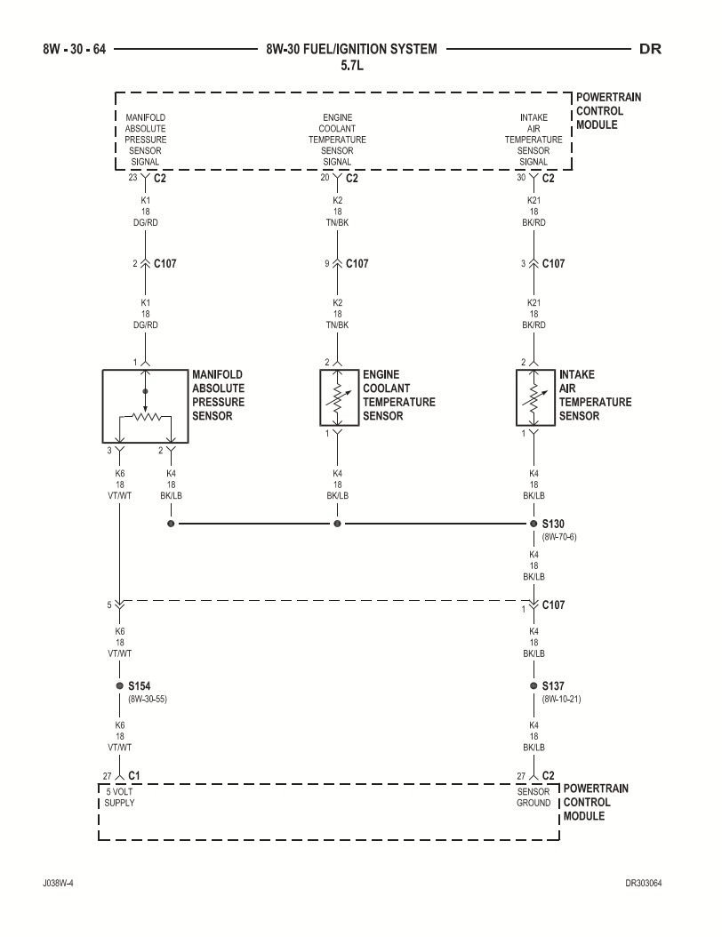

Yeah, I verified my 5 volt reference no short to power that's what led me to a possible bad ground according to the wiring diagram all the sensors share a power and a ground. map sensor and throttle are aftermarket. Everything works fine sometimes for a few days then it hiccups. and boom no power. that's another reason i am leaning towards a wire issue, but if it were the signal wire giving and issue i wouldn't have signal to high, it should be a signal to low, I know I'm overthinking it and it's something simple, I ordered the OEM map sensor today going to try it Thursday see what happens. If anyone has any input and or thoughts it would be appreciated, i don't want to keep throwing parts at it...
