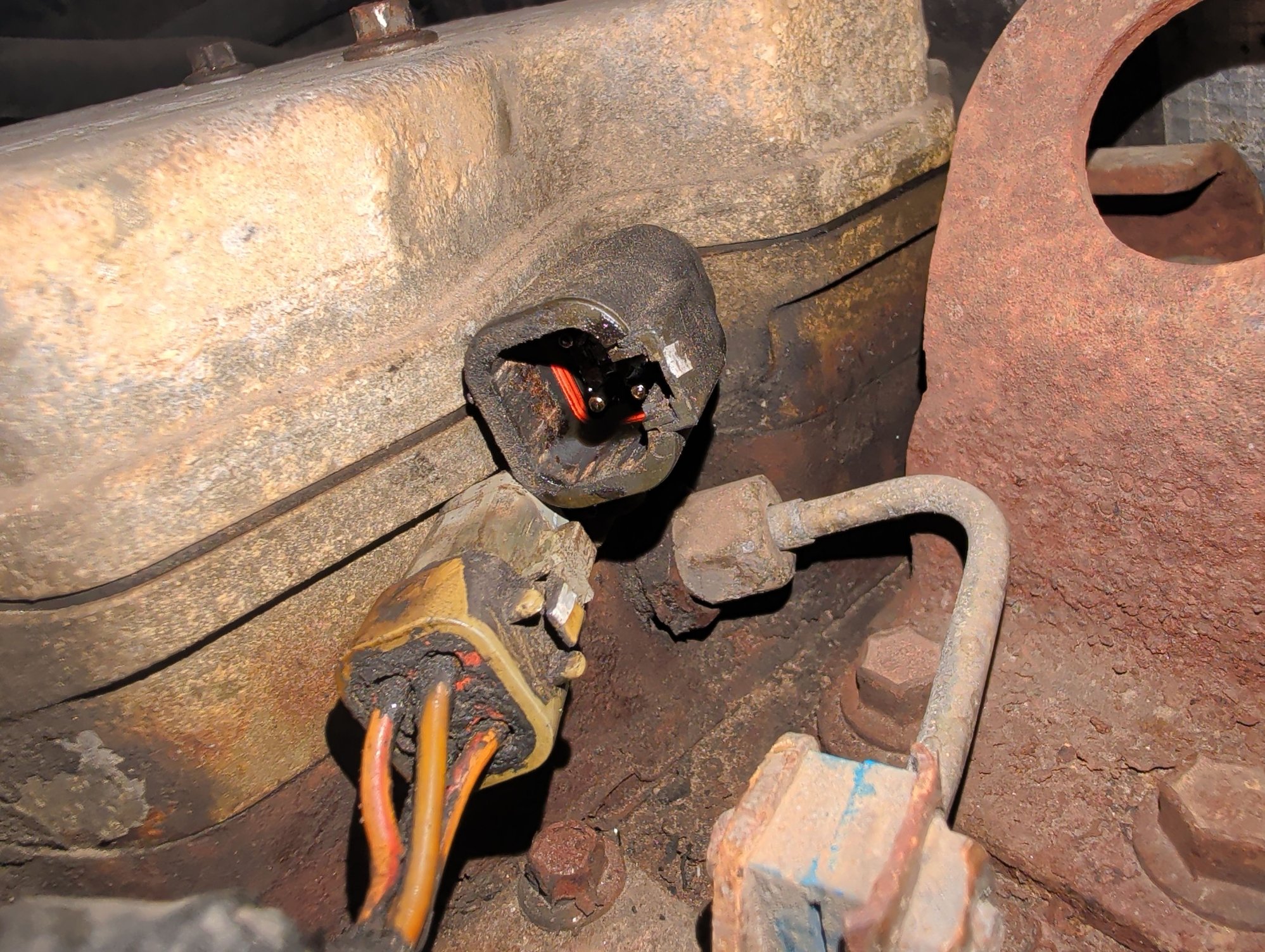

I just took the cover off and probed the 2 prongs on the injectors them selfs for some reason there was oil in the plug ins to the injectors not sure if that's normal or not but did notice that
Today it didn't lope wonder if it's because it's like 80

Default Anyway this could be the culprit oil in connecters on all 3

I wouldn't be overly concerned buy it, new injector harness wouldn't be the worst investment though
