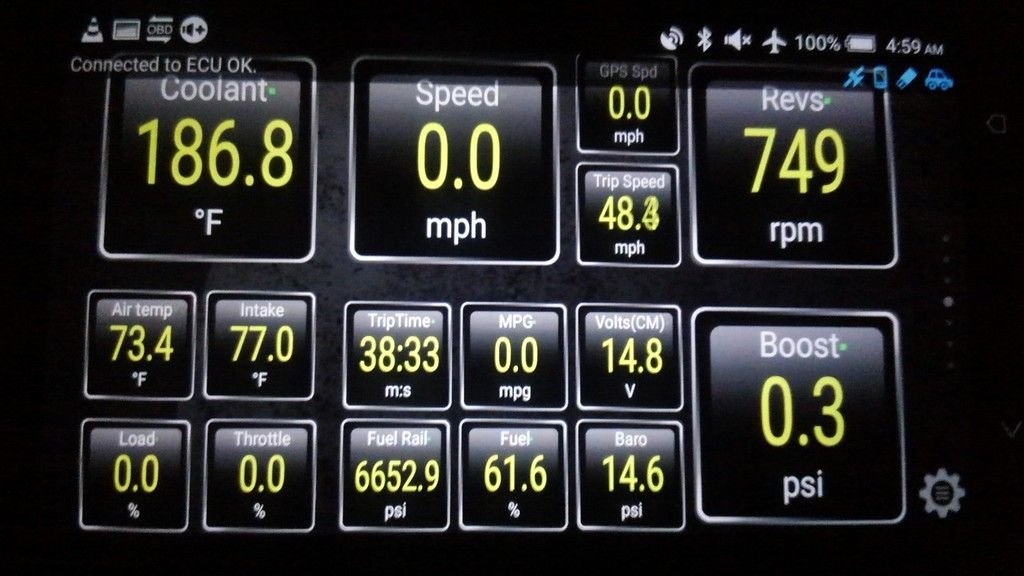

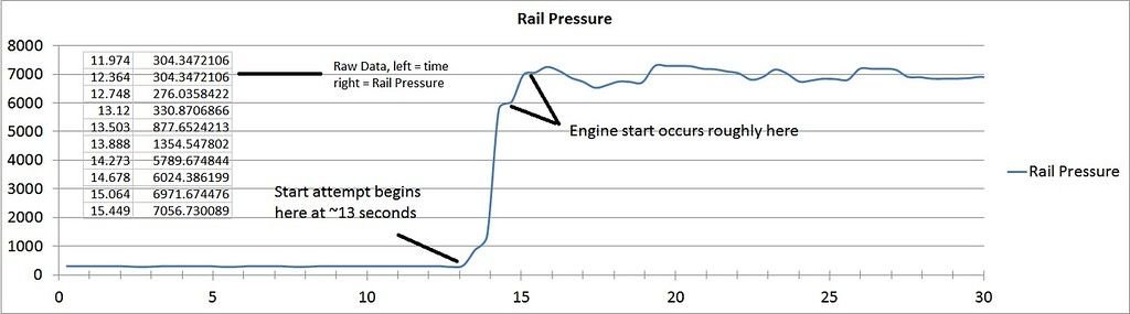

Get a scan tool that can read rail pressure... I use a scantool.net MX bluetooth unit & the Torque app.
Check to see if rail pressure is coming up as expected. The CP3 injection pump will pull fuel from the tank with a dead lift pump. If you swap the fuel filter with a dead lift pump, your dead in the water & need to replace the lift pump (as mentioned earlier the prime is gone)
Here is a graph of the rail pressure on my 5.9
and an example of the data I see on my Torque app, rail pressure on the bottom row is at idle.
