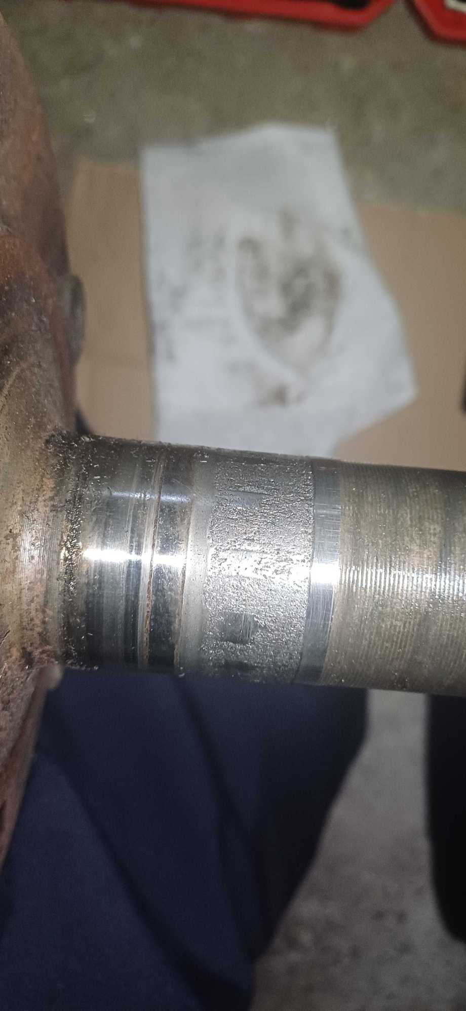

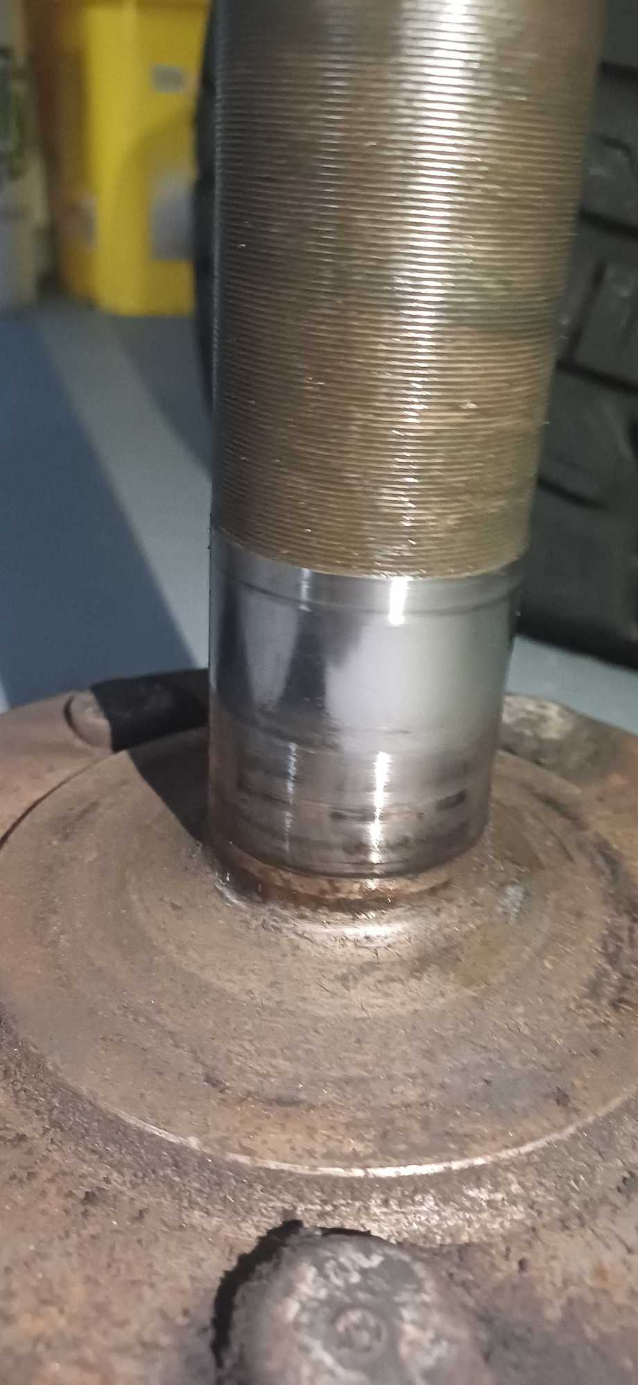

So I decided to go ahead and start tearing into it to see what was going on. The gears look perfect and there's no notable wear besides some metal flakes on the magnet, which is to be expected. All of the carrier bearings and pinion bearings look pretty much fantastic, I'm going to replace them anyway since I'm already in here, got some new timkens. I've recently replaced the rear wheel bearings but as an amateur I didn't check the axle surface the bearing rides on (I did the job in the dark to be honest..) And I've noticed that the surface the passenger axle shaft rides on is extremely pitted and rough...
Driver Side Axle Shaft
Driver Side Axle Shaft, looks okay, nothing catches on fingernail
Passenger Side Axle Shaft. Heavily pitted and rough.
Is it possible this could be the sound of my "Wha wha wha wha" and my rapid "thunk thunk thunk" sound? I'm figuring the only real fix to this is to buy new axles. The wheel bearings themselves are new, and inspecting them they still look good, weirdly the old ones looked perfect when I took them out too, despite the axle looking like this.
I also noticed that when the rear of my truck was jacked up in the air and running in drive, the rear wheels had a noticeable wobble to them, like the axles were bent, but they look straight, and checking them with my ruler as best as I can dont appear to be bent. Is it normal for the rear wheels to have some slight wobble to them when jacked up in the air and running in drive? I know in and out play is normal due to the c-clips in the carrier. The tires are wearing normally, and are relatively new and have been balanced not long ago.

I'd be replacing that axle, at the very least.....
Do the bearing rollers ride directly ON the axle? Or is there an inner race that axle slips thru?
They do, there's no inner sleeve, which is interesting. I went ahead and ordered two new Dana axles off rock auto. Which won't be here until the 4th unfortunately. I used a screwdriver under the truck while it was running on stands to try to pinpoint the noise but it was pretty inconclusive, everything sounded grindy. But it was super loud on that side with the bad axle surface, and now I know why.
