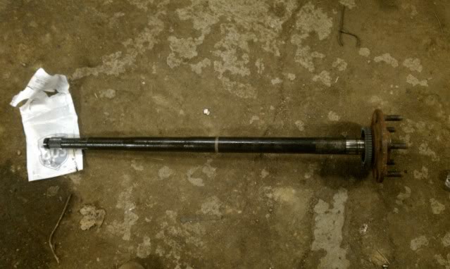

Changed out a rear axle shaft in my 2009 Ram Sport Crew Cab.
dodgetruckparts.com got the shaft to me in about two weeks. They need to learn what available means. They also told me it wouldn't come with studs. So $30 for studs and when it showed up, it had the studs pressed in it and a bag with the extra studs I ordered.
Pretty straight forward.

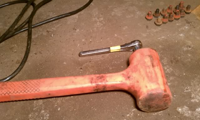

Remove the 13mm bolts on the diff cover. 12 of them.
Whack the cover with a rubber hammer to break the rtv seal and let the fluid drain into a pan.

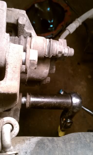

Remove the two 21mm bolts for the caliper mounting bracket and remove the caliper assembly.

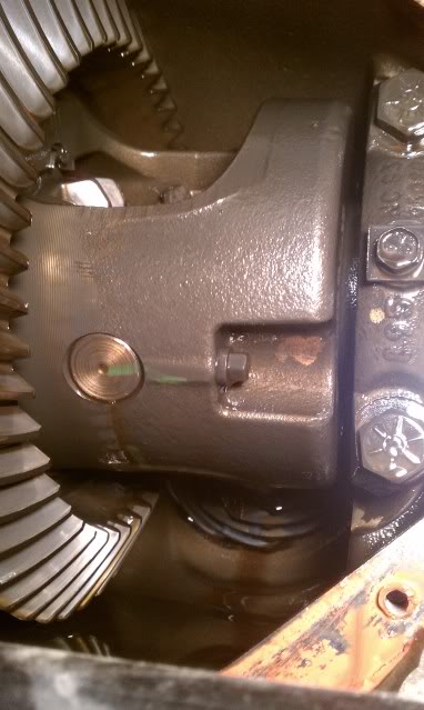

Remove the 8mm bolt/pin for the cross shaft in the carrier.
Remove the cross shaft. It should just push out. This is also why I left one wheel on, so that it was easy to turn the carrier to get to everything.
Push the axle shaft in and the C clip will fall off of the end of the shaft. You may have to use your finger or a pick if yours is gummed up a bit.
Pull the shaft out while taking care not to mess up the axle seals with the c clip groove.
Put in the new shaft. I put a little gear oil on the shaft to help protect the seal.

Put the cross shaft back in.
Put the 8mm bolt/pin back in the carrier to hold the cross shaft.

While this was happening, I put the rotor, caliper assembly, and both 21mm bolts back in.

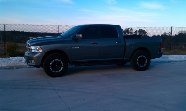

Put your wheel back on and get your truck on the ground.

Bent Shaft

21mm caliper assembly bolts

Cross Shaft retention pin/bolt

Diff cover motivator

Back on the road.
