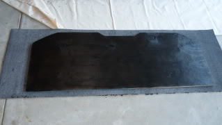

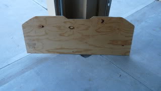

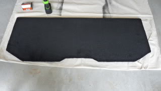

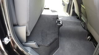

Default Crew Cab Storage Compartment Cover
As promised. All done. Works great and looks factory.
Total cost about $50 or so. The majority of the expense was the automotive carpet.

Looks good! I had to have the fold flat floor so I could put my dog crate in the back.

Thanks, I had to have just the cover, so my dogs wouldn't step on everything in the compartments. The things we do for our pets...

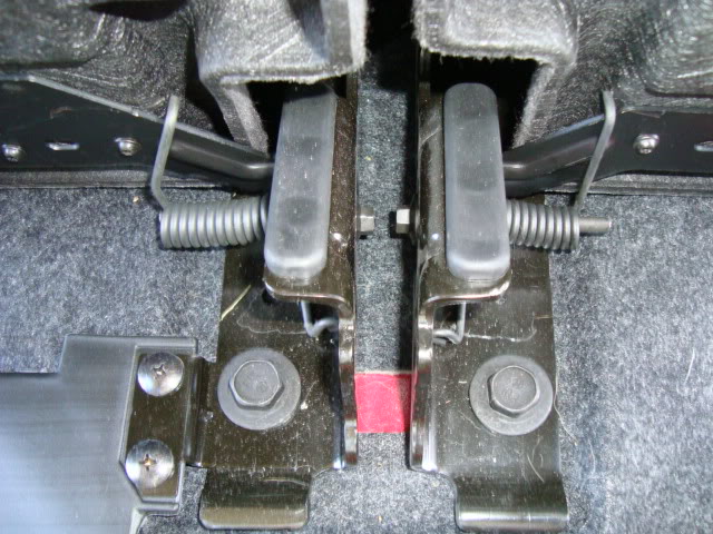

I should have my floor kit tomorrow. Bubba, do you have any install hints or observations for me like hidden or difficult fasteners?
Old May 31, 2009 | 05:53 PM
  #49
BubbaRadioNetwork's Avatar
BubbaRadioNetwork
Joined: Apr 2009
Posts: 422
From: Indiana
The difficult part is the inside bolts the springs are on. Once you remove the springs, break the bolts loose with a wrench. You then have to back the screw out by hand using the part the spring was covering. These bolts will not come out of the seat brackets unless you remove a seat. They back up against each other. You have to pull the lid toward you while turning the bolt by hand. If you want you can put some tape over the bolts to keep them from rattling after removal of the lids. I just left mine loose and I don't hear them. Everything else is easy.

Forgot to add: if you have the sub, mount the sub brackets on top of the fold flat floor brackets.
