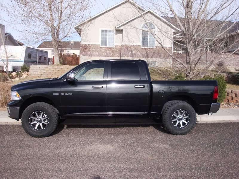

Several of us on the forum have a leveling kit and 35" tires, and we have all posted pictures of them before. This will keep you from having to find them though. Here's mine.

ok, i forgot to add. i meant 35",s on stock or similiar size 20" rims.. superlift said it would fit.

Yep 35" is 35" but your backspacing and width will make the difference too.

The stock wheels on my Laramie were 20x9 with a +19 offset. The aftermarket wheels on my Laramie in the picture above are 20x9 with a +18 offset. You will not find an aftermarket wheel that is more similar to stock than that.
