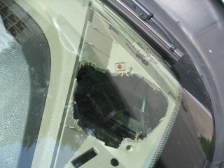

Finished installing my other dash speaker, it was not as difficult as the driver (probably because I knew what I was getting into.) It is still messy, I would clean it up, but you can't see it. I will also need to add a screw, but it is secure now. I will be on a road trip so I will listen for anything, then fix it when I return.
The factory dash speakers are 8 ohm, so any 4 ohm speaker will probably put out more sound.
It was stressing to cut up the speaker area, but it is not as bad as it looks, just messy.
