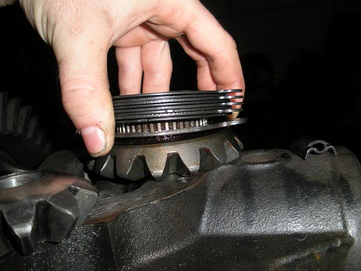

It's a Dana 44 rear end with stacked metal to metal clutches on the spider gears for LSD. Not highly rated by the experts.
did have an issue w/ the c clips breaking and sometimes grenading the rear
clip mentioned above is adjacent to the index finger in the photo

If the pictures here are accurate, the factory lsd appears to be a trac loc.
http://www.dakota-durango.com/forum/...ad.php?t=91729
