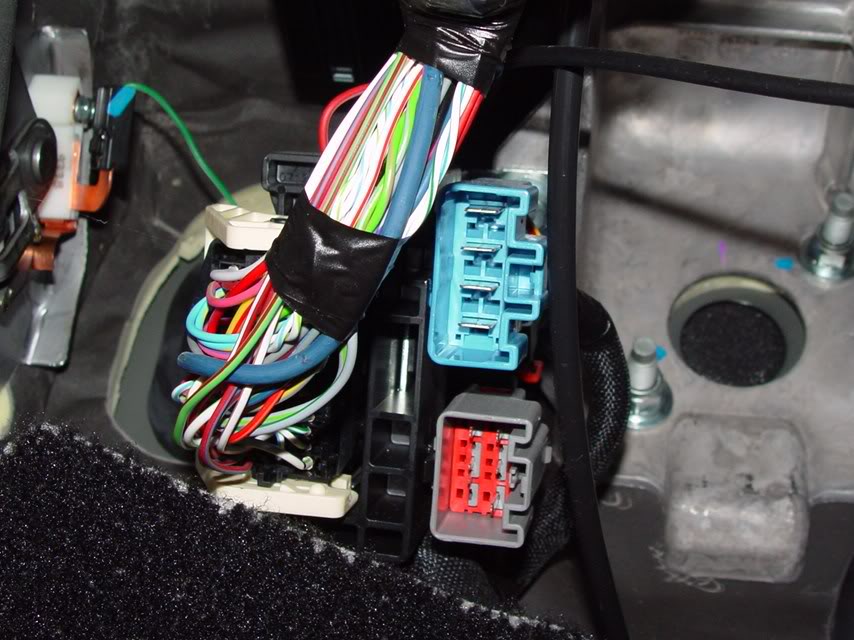

View this pic .. is this what im looking for ? .. which do i have ? thanks

Thats the old style plug, 2010 doesnt have that blue connector at all.
It just pops off, push it from the botton on the inside to start it and then just pull it off, pull the weatherstrip off near it and it will make easier to get it out.
