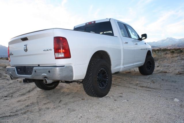

Here's a couple pics!
Attached Thumbnails Bilstien Height Adjustable Shocks-trk1.jpg   Bilstien Height Adjustable Shocks-trk2.jpg

Nice looking ride Big,I'm thinking of getting these also.Do these mess with the factory warranty,or are they OK?My truck only has 175 miles on it,would hate to void anything.
