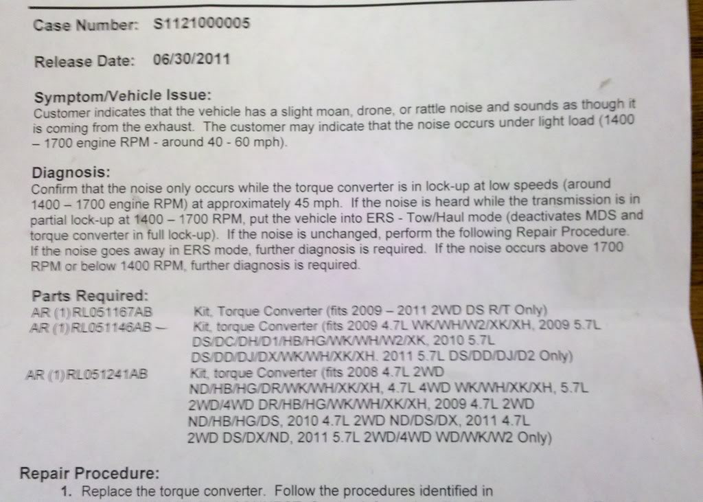

Hey guys new to this board but I had the same TC problem had it fixed and here is some helpful info if you donot have it

Hey bassram thanks . What style truck u have and was that paper from service dept.?
I have a 2011 Ram 1500 Sport had 1200 miles on her when I hade the TC replaced. Yes it came from a dealer.
