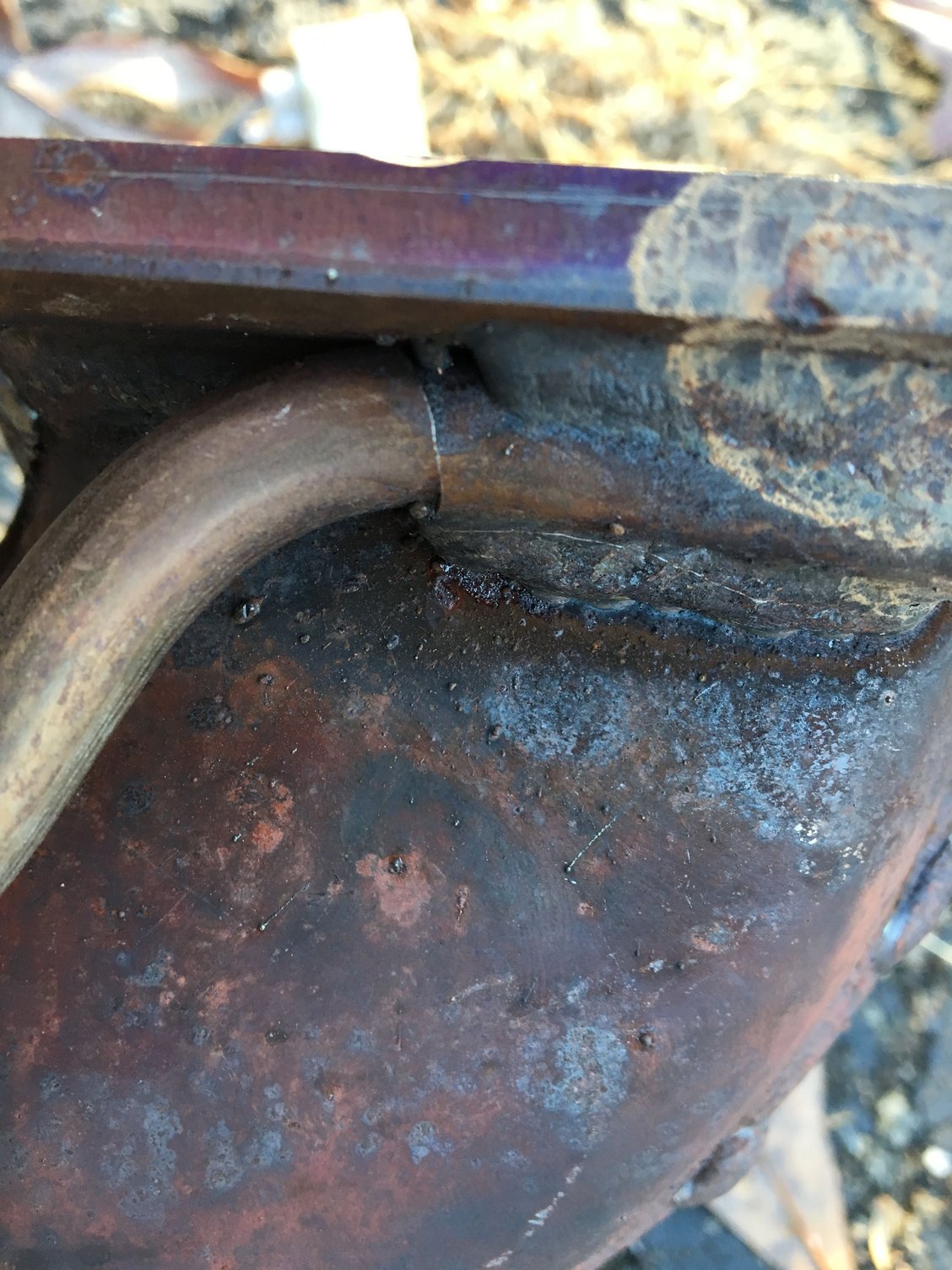

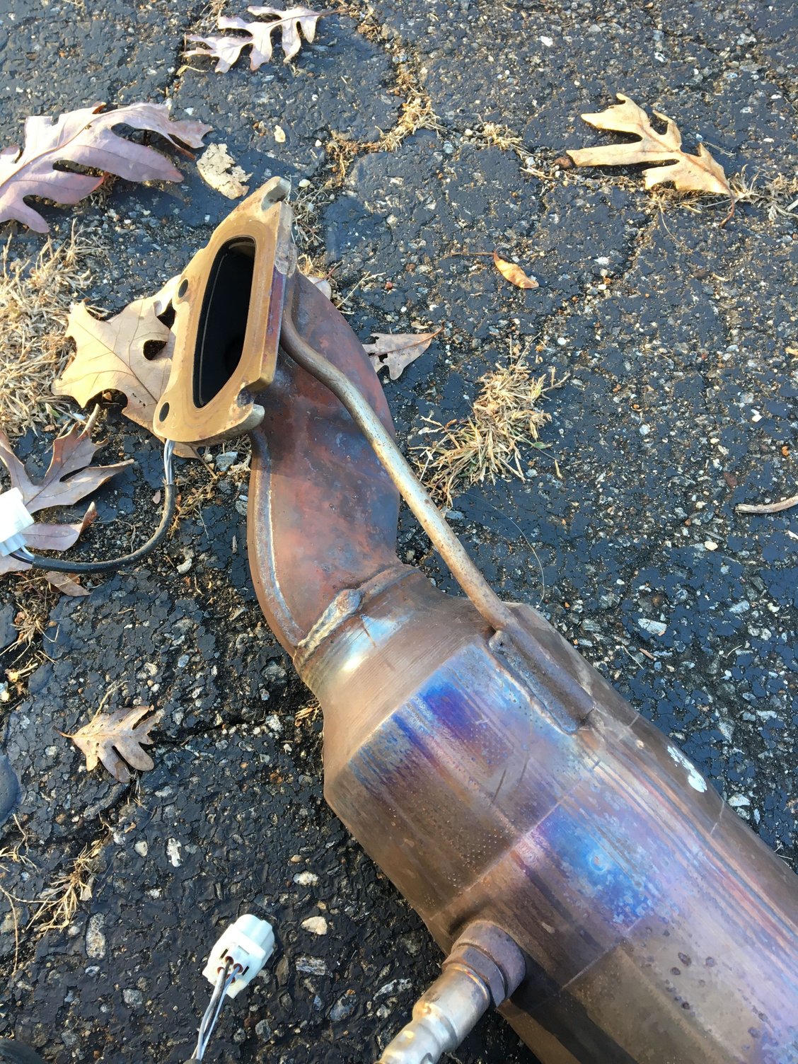

Ok. I found this forum trying to figure out what was causing this rattle in my ram 1500 going uphill around 1900-2100 rpms. As I see no one else found a solution I'll tell you what mine was. I brought it to a mechanic today to try to find the source of the rattle only to have him tell me he's not wasting his day trying to find it. So I got pissed went home and started taking EVERYTHING apart. I had read a few places people had replaced a cat converter and that fixed it. So I took off one of my cats and checked the comb and no rattle, upon further inspected I noticed the support arm welded on had BROKE up near the manifold. So I sent it to my buds house to weld back on since all I have is a braze and silver sod. BOOM problem fixed. It's in such an obscure spot I did not see the break (I had looked before) until I had taken it off. So if anyone is having this issue check out those support arms on your cats I bet that's it. You can see the tack job ram had done around it so you KNOW they know about this issue.
Cheers
