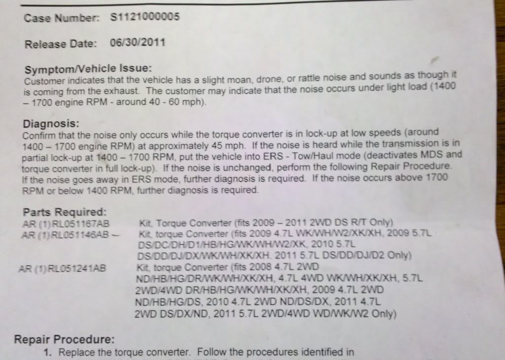

as i said i would give you all a report. i picked up the truck this morning and believe it or not it is 99.9 improved no more rattle,vibration,mds comes on quicker stays on with light acceleration all the way from 25 mph to 45 mph,no vibration at 70mph. mileage on the lie-o-meter has never gone over 19.5 at 70 all of a sudden i'm up to 22.4 on a flat florida interstate.
Don't let anybody at the dealerships or chrysler tell you there is nothing wrong,BULLS***T mine is a prime example of what perserverance can do.tell them to look up the star case from june 2011 and read it.

Time will tell BigAl, time will tell, if that really does fix it. I`ve talked to others and they had a new TQ and the noise did come back.
Is ther anyplace we can get the exact info on this "StarCase" thing...? I`m still not clear on what you`re talking about when you say "StarCase"

Hey guys new to this forum but posted this in another TC subject but thought I would put it here to if helps anyone there is a star case for the TC problem had mine fixed with new TC here is the infoe to put your dealer in there place
