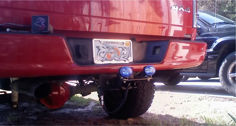

I still have the lights, they live in my toolbox til I need them. Because I made them out of a 2" pipe and they slide in the receiver, I can't tow or have anything else in there with the lights. I've been meaning to make another set that will slide over the receiver so I can leave them on and still use the hitch to tow. Just haven't gotten around to it yet...
For those who haven't seen the lights I made up. Nothing radical, I got the idea from a receiver mount back-up light set I saw in an auto parts store, but I just couldn't see $79 for the cheap plastic that it was, so I made one up out of steel for about $8 ($22 if you include the price of the lights). The switch you see just to the side of the lights allows me to use them as auxiliary reverse lights when the switch is off and as constant on, when the switch is on.

Not to hi-jack here, but i had a thought.... how would it work out if you were to mount the lights on a flat piece of steel either on top (just under the ball) or below the ball on the hitch itself... that way they would always be on the hitch instead of the the truck. Ever since seeing your hitch lights, i`ve been working on a tailgate with flush mounted lights right in the tailgate.

It would be a simple matter to just use a 2 1/4" square pipe (and I have a 2' piece just laying in the garage. Sleeves perfectly over a 2" square pipe and all I'd have to do is tap a hole for a set screw, BUT the stupid lip they have on the end of the hitch kills that idea.
