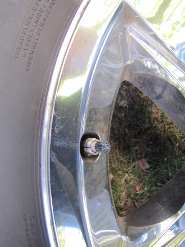

Found both my front tires stems cracked while I was doing my brakes today. When I called the dealer they said $80.00 a piece. I have 7/70 and they said they were covered but I have a $100.00 deductible so it really doesn't help that much.

if you have the sensors rebuilt every time you change the tires you will never have this issue. the rebuild kit is 10 bucks a piece... DO NOT GET A WHOLE NEW SENSOR...you dont need that part. the kit includes a rubber gasket, a new retaining nut which should be torqued to specs, and a valve core. if you ever have this problem take it to discount tire, tell them you have a flat ( which they do for free) and the tpms rebuild kit is included with the free service.

The rebuild kit only replaces the nut and seals, not the stem and mine did get a new kit at around 45K when I got the tires. The problem on mine was caused by the stem corroding inside the nut.

You don't need to replace the whole tpms. Any tire store will have the kit and stem. parts cost is around $15 from the tire store or $8 at the local auto parts store
