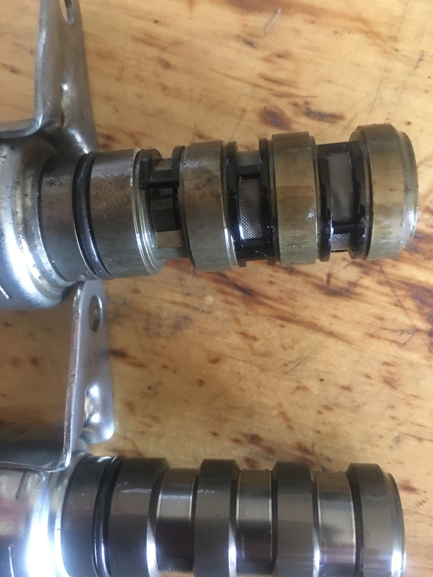

d0dg3's Avatar
d0dg3
Joined: Jun 2011
Posts: 7
Default Short answer is yes.
Originally Posted by Bigblue10
My 2010 has this issue now. I’m wondering if just disabling the MDS with my tuner would be an ok solution? Or if it will still cause issues inside the motor. I think I might try to replace the timing chain, tension, guide and phaser one of these days, but until funds are available, could turning MDS off save anymore wear and tear?
First let’s define the noise we are discussing. Turn off the radio, roll down the windows. Leave the MDS activated. Drive slowly on a quiet flat side road, preferably one along a fence or wall. As long as the engine is not under load, somewhere around 2000 rpm’s the noise will start. It sounds like a baseball card in a bicycle wheel. If you turn off the MDS while the sound is occurring the ticking will stop instantly it will also stop if you accelerate hard or the rpms drop low enough.
At this point I’m pretty certain of the cause. It has to do with the programming that retards the timing under the above described driving conditions. I’ve had a scanner hooked up and watched it happen as the timing gets retarded. That’s why turning off the MDS stops the noise. The timing doesn’t get retarded as far when it’s off. That’s also why replacing the cam phaser solves the problem. Now the one thing that I have also read is that it might not actually be the cam phaser itself causing the problem but rather a worn key in the key way that holds the phaser in place. I’m betting that anyone who solved this by replacing the cam phaser also replaced the key as well. So it might be possible to fix the problem by somehow shimming the key if it’s even accessible without removing the phaser. The good thing is that other than being an annoying sound it’s not likely to do any real damage to the engine imho. Now the MDS solenoid does need to be replaced imho. I believe that screen can possibly cause a lifter to not get enough oil and ruin the camshaft.
Old one in top picture is missing screen because plastic got brittle. Notice the replacement uses a stainless screen with no plastic.
You're making ref to a MDS solenoid but posting pics of cam phaser oil control valves (OCV). Notwithstanding, and as I'd iterated way back in this thread, I replaced the OCV on the beast @ 60K miles. There were bits and pieces of the screen missing on the OE OCV. The replacement (updated) part incorporated a permeable foil as depicted in your pics.
Ironically, and concurrent with my recent endeavour to finally replace the cam phaser, I discover that the cam is toast with a little less than 88k miles on the clock. Repair options are limited in my neck of the woods but ultimately I decide to replace the engine. However, and as of late, getting a long block from FCA is a gong show! Initially advised that it'd be a couple of weeks, then a couple of months. More recently I'm told that it could be the end of the summer to get a replacement engine. Why? Here's my theory: FCA cant keep up with demand for replacement 5.7 Hemi engines to fix trucks wherein their engines are eating their valve trains. The dealer/s will play dumb about this debacle and will hand ya worthless platitudes.
Anyhow... any endearment I had for the half-ton beast is long gone. She's been sold off (as is) down the road. Done with Hemi engines - time for something with a rep for longevity...
